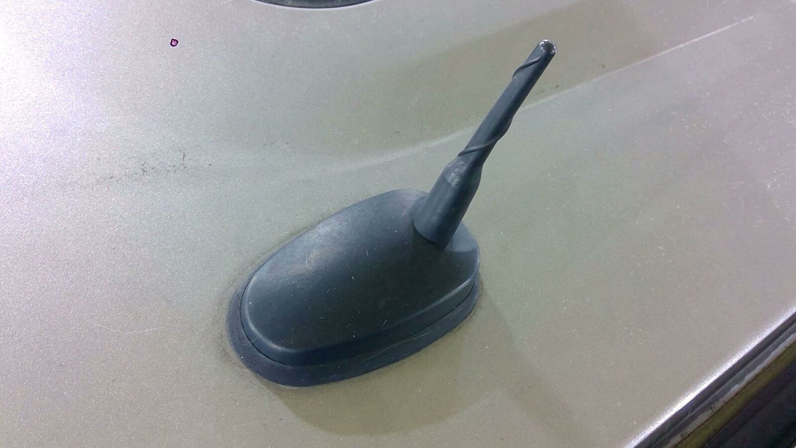

OP stated has xm radio.. here's a pic of the oem gps antenna on an '03 H2(however many may have removed/destroyed over the last 17yrs):
