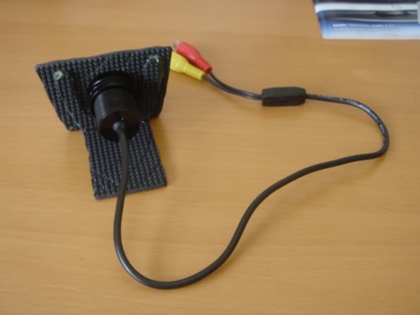

made this bracket from scratch for the cam...

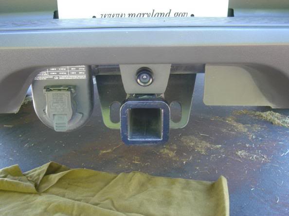

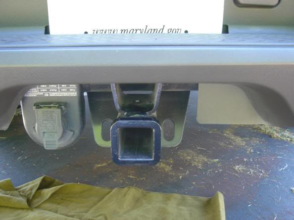

before and after on cam location:

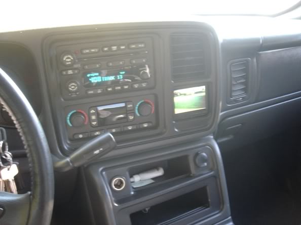

3.5" monitor in what used to be the dash opening (excuse poor pic quality):

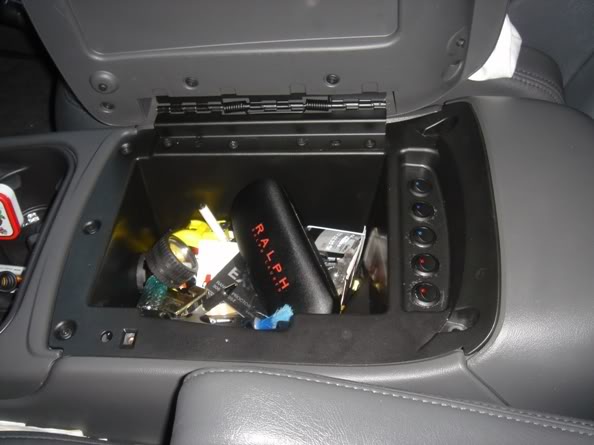

and the switches, one for the cam, one for radar, couple of blanks for if i want to add more stuff:

i basically keep it on all the time. again, HTH for an idea at least..... [sm=smiley1.gif]
