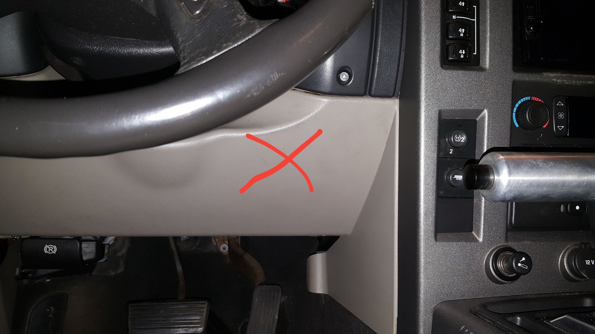

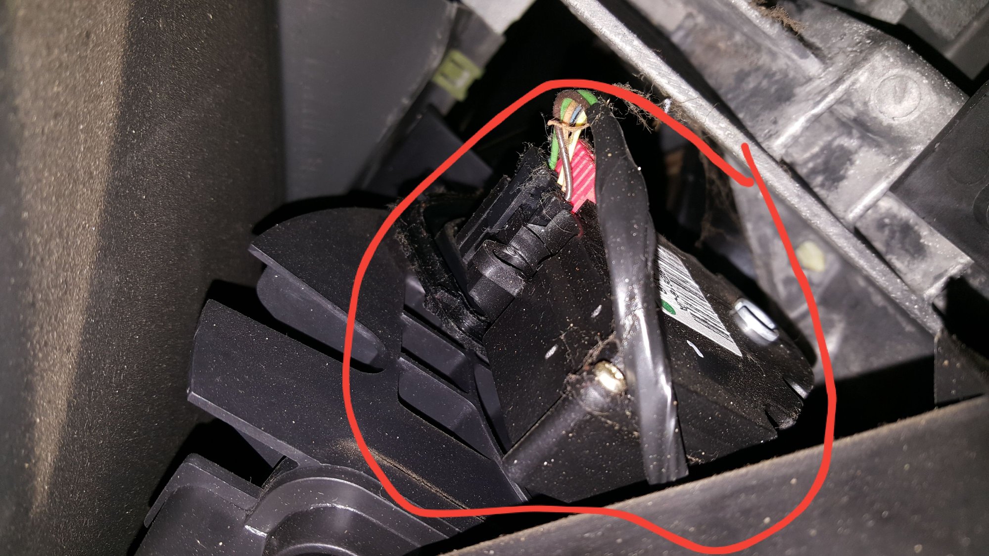

It is located approximately here:
Here is a shot from laying underneath where the foot pedals are:

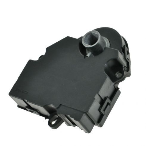

It is the only 1 of the 4 that are on the drivers side so when you see it you'll know. You don't have to take anything apart of the interior except the 2 bolts off of the actuator and unplug the wiring. They look like this:

I mean you can start taking things apart if that will help you, but it is possible to get it off without removing anything. Just be advised that this is the easy one to get to. When it comes to the passenger side actuators, you are basically working blind with way less hand space than this one, and have to take literally everything apart. You need an 8mm box wrench, and you just need to feel for the 2 bolts and attach the wrench, then take your time to work them off. After the bolts are off, you unclip the plug and pull the actuator off. When I was changing the one on the passenger side I also felt it was impossible at first without cutting the vent out, but you just have to have a lot of patience.
