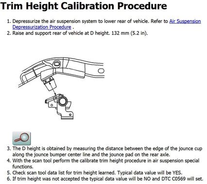

As far as I'm aware, the Tech2 is the only tool that can calibrate ride-height, it's not to say yours can't as technology moves on, but that's the way it seems.
From the GM Manual the Air Suspension Depressurization procedure is as follows:-
To depressurize the Air Suspension System install the scan tool with key in the on position. Go to the special functions menu of the Air Suspension section and follow the on screen directions. The suspension will deflate the air springs until the suspension is on the jounce bumpers
From the GM manual for calibration to be achieved, both sensors must be in the range 2.06V to 2.88V
T
he "Jounce" tool CH-47816 are blocks that mount over the bump stops, they are expensive, hard to find and unnecessary, though personally I'd like a set.
Put the truck on level ground, jack the differential to achieve the correct trim height and follow the "Trim Height Calibration Procedure"
Re depressurization, it sounds like your truck lowers itself anyway (you quote 1.41V and 0.35V) so with the rear wheels on the ground and the trim-height set at 5.2" your diagnostic tool should read somewhere around 2.5V on each sensor, if not you may have an issue, otherwise you can try the trim height calibration below.
If depressurization is not achievable, it may possible to do it manually taking great care and is not recommended! Gently release the air bag lines, note there could be around 40psi in the each line, the rear needs supporting very safely incase of any sudden lost or change in suspension.
From the GM Manual Suspension Position Calibration is as follows:-
T
