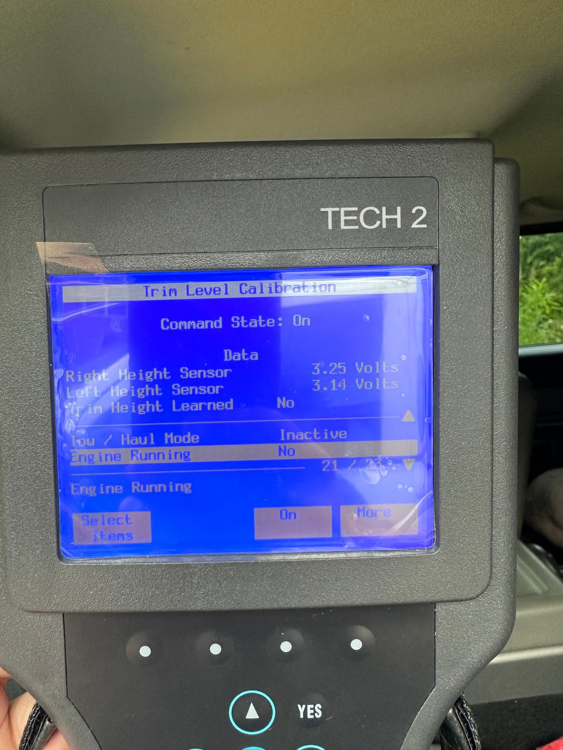

Ok. Looks like it will only depressurize if it is not on the Jack stands. So I did that then jacked it up to my desired ride height. Then ran the trim level calibration and still nothing. It doesn’t ever say calibrating.
any other ideas out there?

Posts: 18
It will show command state on when I push the on button but. Never says calibrated after that.

It could be your ride-height sensor readings are a little bit too high to start with?
Only theorizing how the software works, but the sensors should be nominally be 2.5V each when at the correct mechanical height (+/- 0.2V ish)
So a normal working range is approx 2.0V to 3.0V (maybe +/- 1") seems about right. With the extended 2" ride-height switch set the values increase to approx 3.4V, i.e. very close to yours.

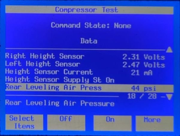

For example here are mine:-
It seems logical to assume the calibration software will not accept values that are too high, perhaps you're attempting to increase the ride-height too much?

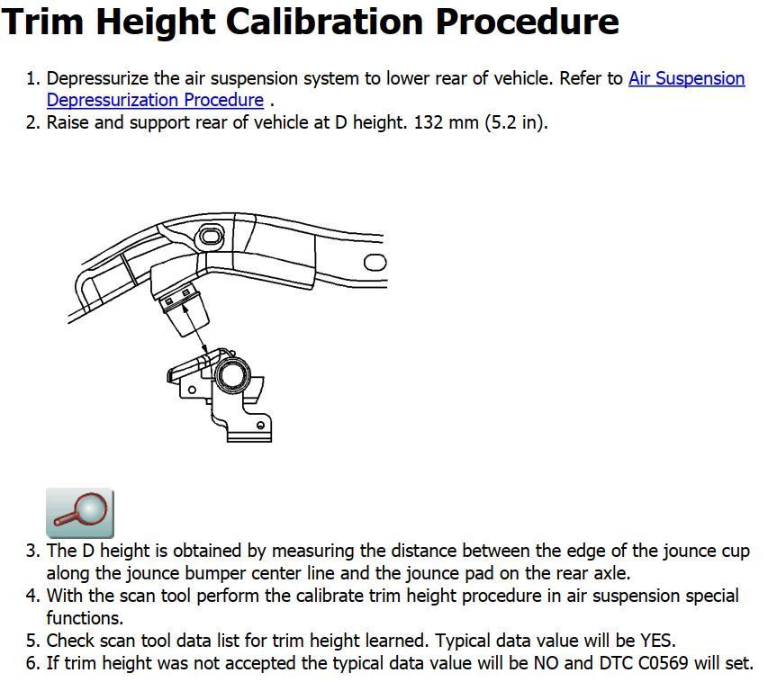

This procedure may help:-
Check the mechanical height then try calibrating

You are probably right Ocean, I’m want it in the 3 volt range and the computer don’t like it. I just wanted a little more clearance for the tires. I guess the only fix/cheat would be to make a little bit longer sensor arms to fake out the computer. I don’t know if I want to go that far.

OK tried to learn level again keeping it under 3.0volts went with 2.92V. Didn’t learn, then dropped it to 2.82V just for the hell of it and it took the learn. So I guess the threshold for learn is somewhere between 2.82 and 2.91V. Didn’t want to mess with it anymore so just left it there. Better than it was and close to what I wanted.
thanks for all the help guys.
