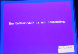

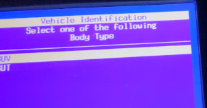

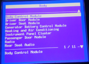

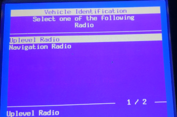

@Mark R
From "F1: Body" you get
Then asks for Vehicle Identification:-
If you have no OnStar you'll get the warning:
From there you can access the Radio sub menu and I believe in there will be the option to program or re-program a GM stock radio and possibly a Nav Unit
Since I have no radio I haven't explored further, however as I mentioned I did re-program a H3 to accept a replacement Radio and I'm fairly sure this ties in the VIN number to a little eeprom device inside the radio. Whether or not the eeprom can simply be cleared and leave the radio functioning I can't say, possibly not, no on-line link was needed.

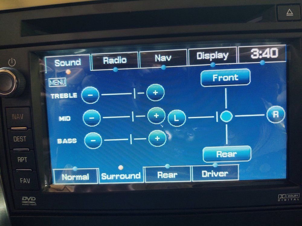

Here's what my screen looks like for the LUX 08 09.

Nice Mark, your making me jealous, you've got the best toys! Sometimes you just can't beat Genuine GM factory equipment the Alpine W957HD has just about every feature you could want but in all honesty I would rather have a Genuine GM Nav back like it had when it rolled down the assembly line. Hopefully in the near future I can pull it out and put another factory unit back in place.
