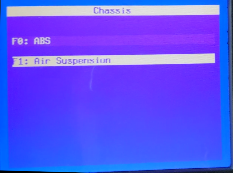

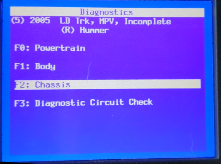

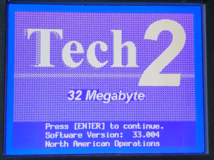

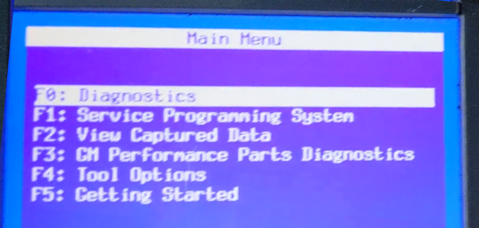

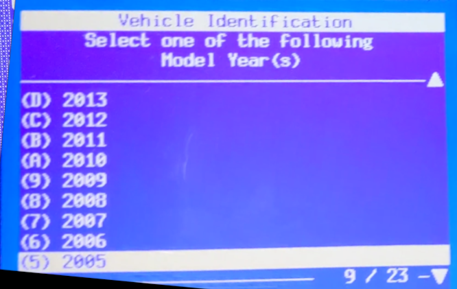

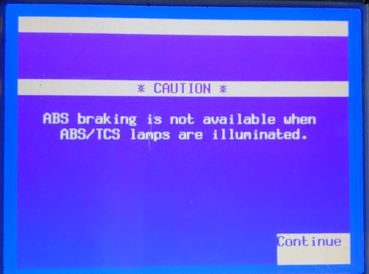

Old Oct 7, 2024 | 05:07 PM
  #90
oceanbrave's Avatar
Joined: Feb 2015
Posts: 1,635
From: Birmingham (UK)
Answer is slightly complicated as the menu structure is different according to the model year (or so it seems) I can only speak for 2005 and possibly upwards.
Power on Tech2 to give the intro splash screen
Then Enter for Main Menu
The F0 to select Diagnostics, then select Model Year (in my case 2005)
Set Vehicle Type to LD Trk etc.
The Vehicle ID (Hummer)
Then choose F2: Chassis
You will then get a *Caution* Screen - hit continue
Press F1 for Air Suspension
The Radio functions I believe are under F1 "Body" but I don't recall there being an "unlock function" per say but rather programming in the VIN to the radio, I have done it for a H3 but it was a while ago, just remember it was fairly easy to do.
