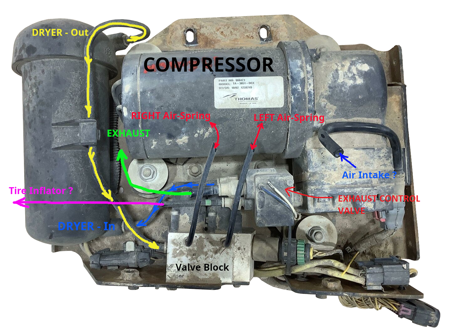

If air cannot be purged or vented the bags will stay inflated, so sounds like the exhaust is blocked or the valve not operating either mechanically, electrically or electronically.
This is what I think an 03 single compressor system might look like:-
