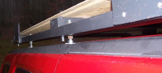

Originally Posted by theindian
Jason is there going to be a nut and washer for spacing between the roof and rack? Or are you making some other kind of bracket to attach to roof and rack?
I dont know if you can see it here, but I welded 2"X2" stock to the rack. IT should sit about 2" above the roof. Also, the reason that I used 2" was so when i put the nut on the stud, I could get a wrench in there and tighten it up.

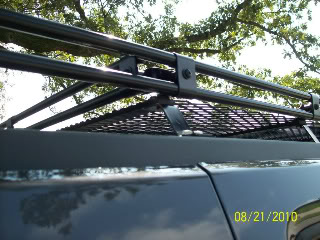

Old Mar 20, 2012 | 09:00 PM
  #34
theindian's Avatar
Joined: Aug 2010
Posts: 33
jason heres a pic of my brackets maybe another option.

Old Mar 20, 2012 | 10:47 PM
  #36
drtom's Avatar
Banned
Posts: 2,652
did you get your measurments for the holes on the rack,
i put three bolts on each side,one at each end,one in the middle. no measurements were made.
i laid the 2,2x4 on the roof and marked each with a pencil line and drilled 5/8 holes for loose fit. sit the 2x4 on the bolts and assm the cross pieces. no measurements. just mark each piece if/when you take it off.
the entire operation took about one hour,then i took it off and painted it.
another hour!
cost less than 20 bucks for wood and bolts/nuts
oh,can you see how ez it is to adjust each bolt/spacer for any curve in roof. just turn the nuts to fit. then snug them up.

Old Mar 21, 2012 | 06:20 AM
  #37
mr.spooky's Avatar
Joined: Nov 2011
Posts: 77
I was wondering about a arch on the roof from front to back. is there a big difference? from the looks of the picture, it looks like the middle might be about 1/4" higher..
thanks
jason

Old Mar 22, 2012 | 12:48 AM
  #39
Put a stright edge or level on that rail and you will see, then try to put the level across the 2 rails. Major "bump".
Instead of the lag bolt Idea I used Unistrut Nuts. Available at your local Home Depot in a 4 pack in various thred sizes!
They stay in place, grab the rail and slide to aid in the perfect centering and fit of yoru roof rack!
Old Mar 22, 2012 | 09:37 AM
  #40
mr.spooky's Avatar
Joined: Nov 2011
Posts: 77
I knew that there was an arch from the left to the right, but i wasent sure if the rails had a arch in the leingth of them (from front to back).
Ill be checkin that when i get home today.... If theres a big diference, its back to the drawing board
thanks!
jason
