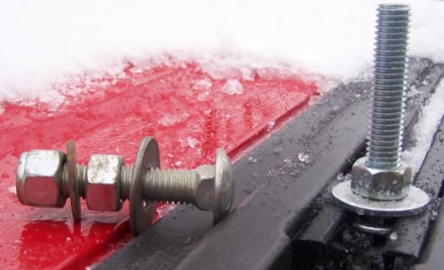

these carriage bolts seem made for h3
cant load pix. 1/2 in carriage bolt,99 cents at lowes.
pix tomorrow!!

finally!
made for h3

Originally Posted by drtom
finally!
made for h3
I thought about doing that in the beginning, but i figured that a bigger "foot print" would be better.
jason

I reattached my Gavin wilderness rack using bolts and fender washers in the channel. It worked great and as soon as I sucked up the bolts with an electric impact, they held tight and did not slip when I tightened it. The carriage bolt idea is pretty cool though!
how tight do you tighten these to the chanels? I thought that you just might snug them,, but your talking about impact wrenches. I dont want to under do it, but im afraid of over doing it too.

kshummer's Avatar
Joined: Aug 2011
Posts: 151
I just used an electric 3/8" impact wrench with bad batteries and snugged them up. It has not fallen off as of yet. My rack from Garvin is somewhat heavy. It takes two people to install it and it has a working weight of around 300 lbs of gear if I remember right. I know I have stood on it to lift hear on and off and I weigh about 275 lbs.
