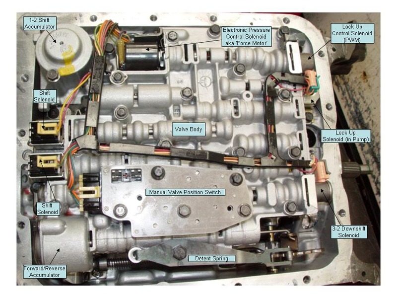

yes, the shift solenoid for the particular shift that is slipping. Either 1/2, 2/3 or the other one. Let me find a picture.

I can't remember which is 1/2 and 2/3, but they are about $25 each so replace both when you drop the pan. Is it only slipping on shifts or under load? With that mileage I am worried about disk packs being worn out.

Thanks for the reply and the pic. It seems to be mainly on shift. It starts to shift and then revs up. Let off and it goes into gear. There is some slipping when gassing it, but that also seems to correspond to the down shift, going into passing gear. Ya, with the mileage, I'm almost just thinking it may need rebuilt. Hoping the solenoid do the trick though.
