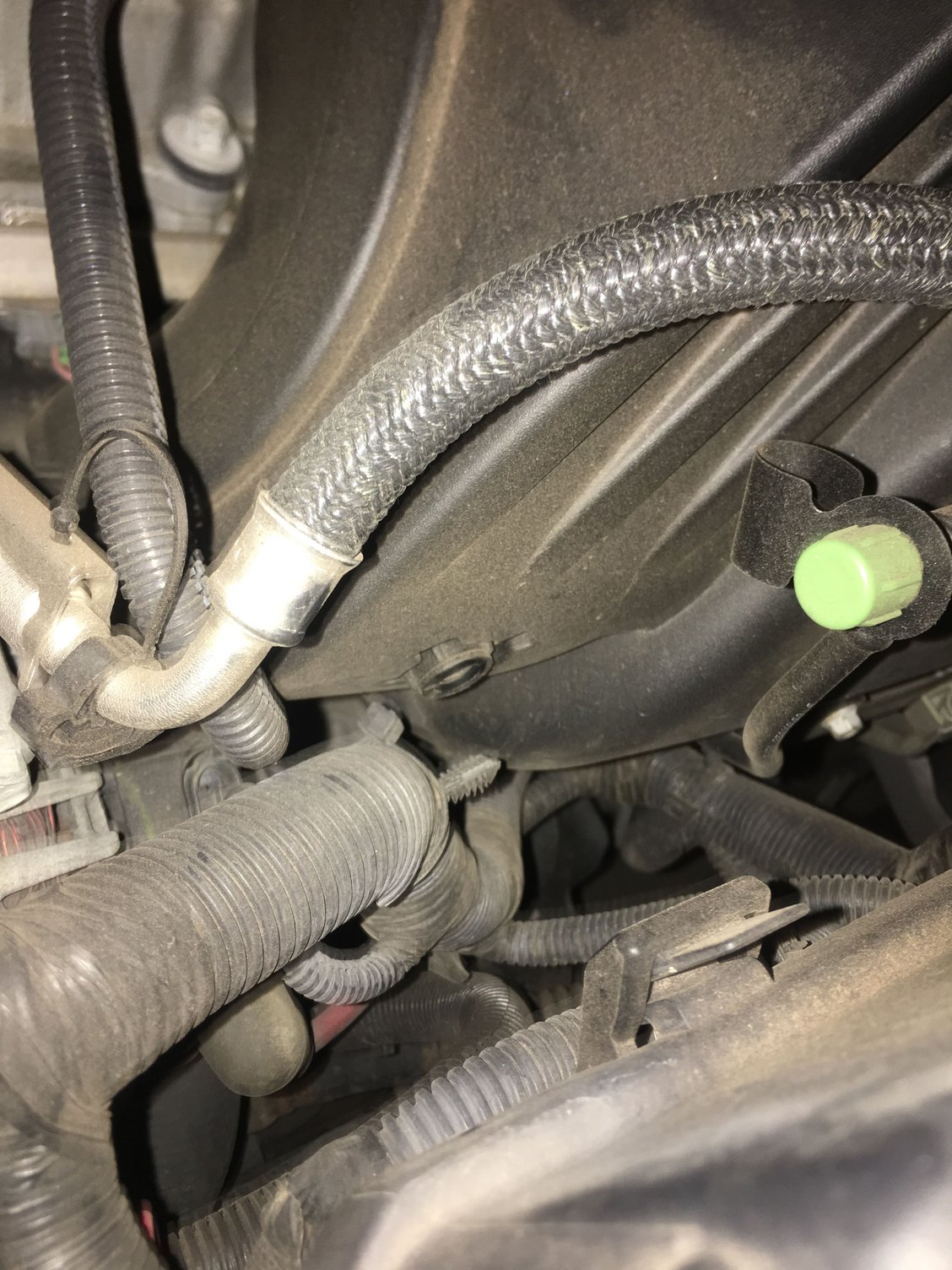

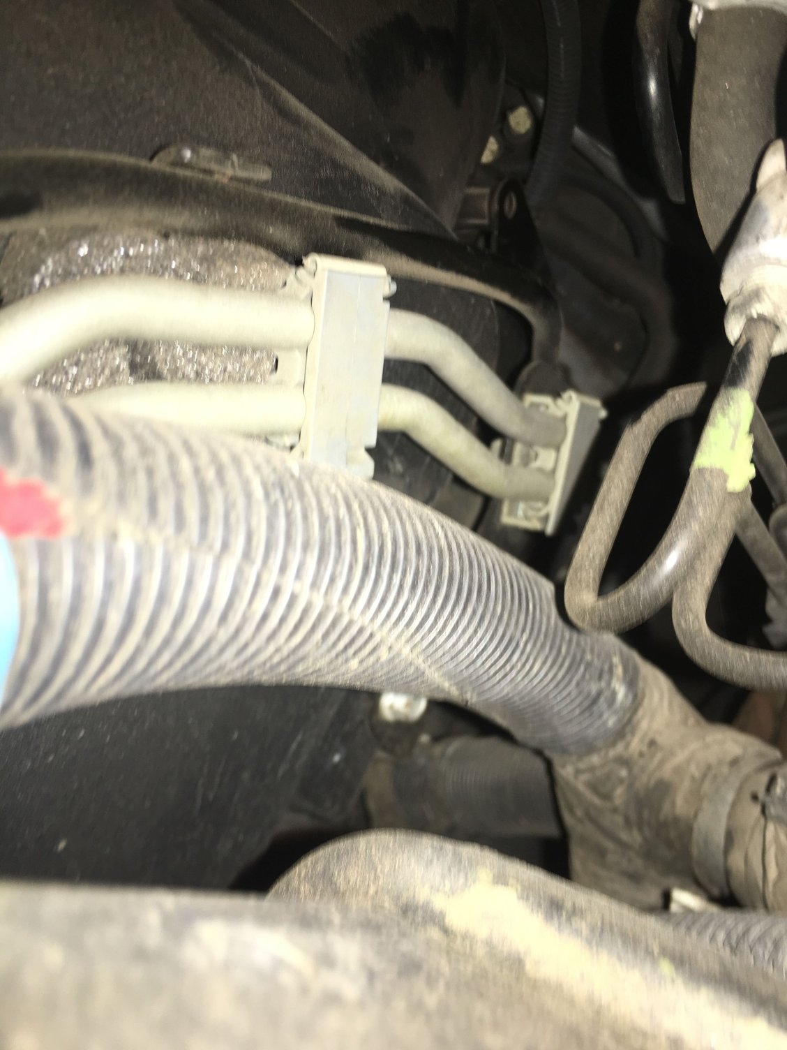

Bolt gone, rattle
Bolt gone?
well I think I may have found the problem I’ve been chasing with my low idle and rattling issue. The bolts aren’t just loose...they’re gone! Could this also be causing my low idle problem? Can anyone (DOC, TAINTER) what size bolts I need for this?
Old Nov 21, 2018 | 07:36 AM
I5 plastic intake bolt size? Dunno. I do have the GM part # 11588352
Sorry, don't have an I5. Maybe someone can remove one and measure it for ya.
I know you will want to use Loctite on'em when you replace them.
YES, that would defiantly cause an idle issue.
Old Nov 21, 2018 | 10:01 AM
X2 that! ^^
Should be 6MM X1 X 48MM .... that is 6MM thread, pitch 1, 48MM long. However, they have a built in spacer.
I think you can get them on ebay for about $6 ea.. I did check that PN, it is correct, but there is also a new PN so confirm before ordering. If you check vehicle fitment it will tell you it is not for a 2007 H3, but I believe that is wrong. You double check it.
