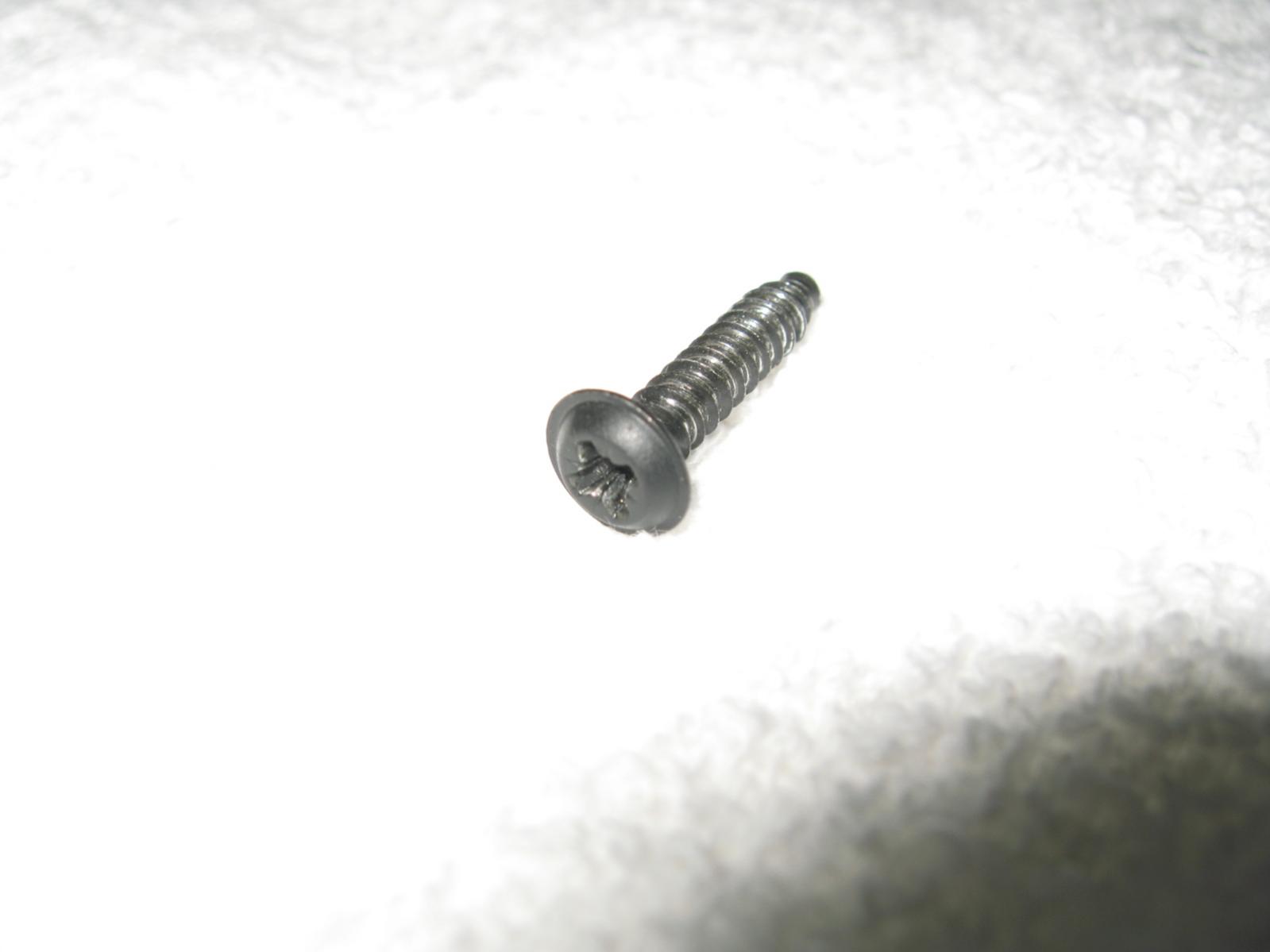

Okay, I went out and pulled one outta the dash to get some measurements off it and came up with a screw just like this one......
http://www.clipsandfasteners.com/4_2...v_p/a12061.htm
but the 13mm length is not correct, it needs to be 19mm long if you want it to be the same length.
The head dia. was the hard part to find out of all the screws at the site, which unless you want a hundred of them, I would get what you need elsewhere. The site does have a lot of automotive fasteners, just a fyi.
My measurements were .165 inch (4.2mm) thread dia. with 18 threads per inch (1.41mm thread pitch = 18 threads per inch) X .75 inch (19mm) in length. Head is a Phillps and is .334 inch (8.5mm) in dia.
Hope this helps, Ed

Thanks Easy!
I couldn't even tell what kind of thread I needed. All of the other stuff for the dash is socket head cap screws with machine threads. I would have been looking for different sizes of those to try at Ace. Looks like that's not what I need at all.
Thanks Again!

No problem TowDawg, hope ya can now find what ya need. They are a GM part but I couldn't find the correct part number for the length, maybe check with a GM dealership and see if they can find it (a good parts guy should be able to) with the info I gave ya.
Later, Easy

self threading,goes into nylon or metal clip,"tinnerman".
try smaller,loose fit,then get one bigger when its a snug fit but goes in, you got it.
go to junk yard and get a hand full free
