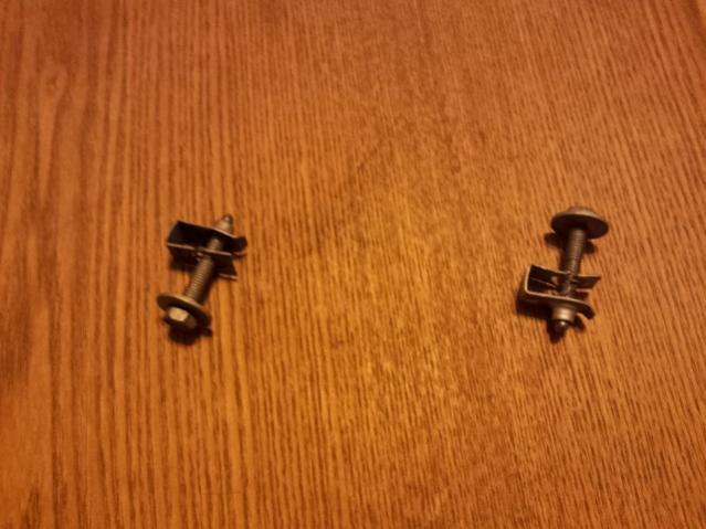

Thought a pic might help.
Chris

Bring those bolts to an old school auto parts store in your area that 's been around for a while, a NAPA or a mom & pop store.
They should be able to match them up and get them for you.
Don't waste your time with the chain auto parts stores like Advance or Autozone.
Old Nov 29, 2012 | 09:30 AM
Posts: 13,113
Or go to a GM truck dealership. Full service body shops will have them as well.
They are called "extruded U nuts". Since they are 10MM mounting bolts (head), the U nuts should be 6MM x 1, but you can check the bolt at the hardware store with their metric thread chart if you want.

Most Ace Hardware-type stores carry them as well.
