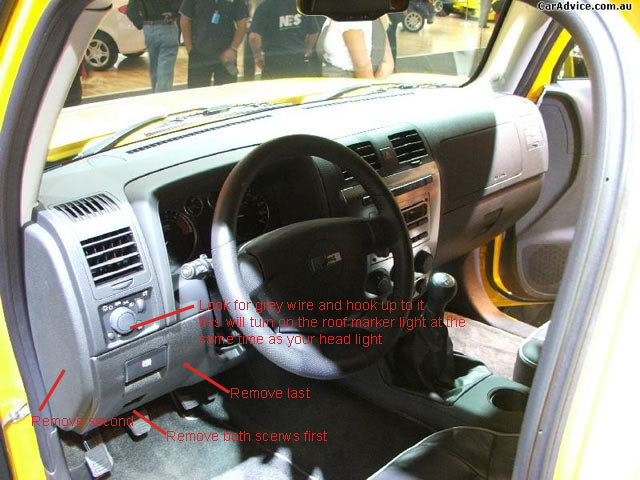

Only lingering question is where's the best place to wire them into the running lights? I want them on when my lights are on, I don't want another switch just for the cab lights.
Have a look at the pic, if your not sure let me know. Good luck
