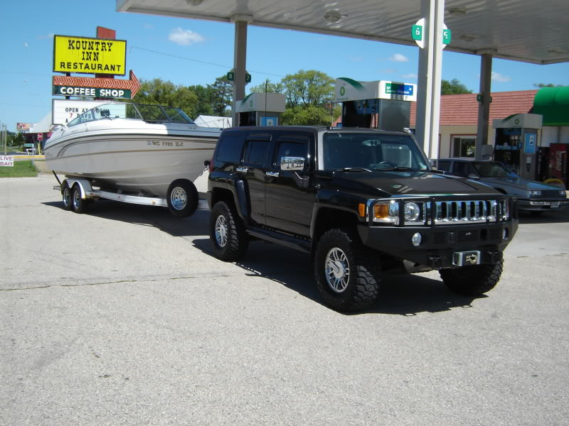

Yeah, completely very much bigly under powered.
When equipped with full off road mods, loaded with tools and floor jack, and weighs nearly 6000# with me in it, my 2007 H3 with Performance (Air Doc Intake, PP TB, PCMofNC.com tune and Efan conversion, MagnaFlow Cat Back exhaust) on 305 MTZs. The boat, Chaparral 2330 7.4L Big Block with Bravo 3 dive and tandem axle trailer appx. 5,500#, hauled from south of Milwaukee back to NE of Detroit (appx 425 miles one way).
70 MPH all the way tucked in behind a friendly 18 wheeler.
It may not be what you are looking for for yanking your horse trailer, short wheel base makes the tail wagging the dog pretty interesting now and then.

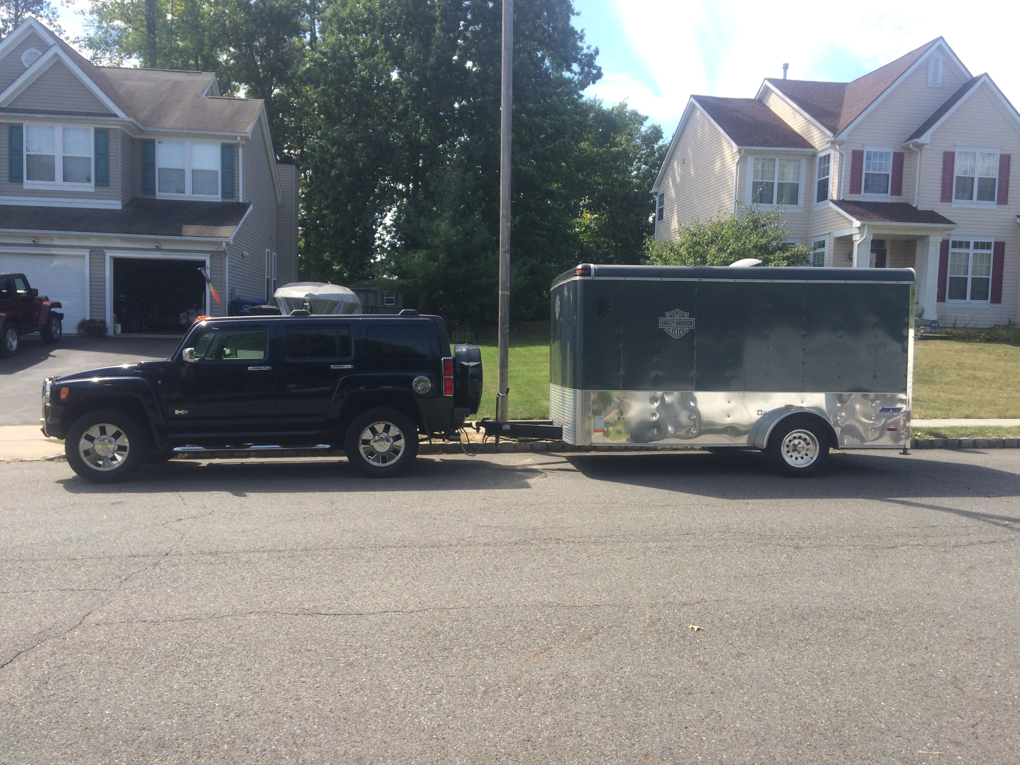

I've towed this rig from NJ to FL and back with two full size Harleys. Total weight of the trailer, bikes, and equipment is about 4000lbs. It will run at about 3100rpms in 3rd gear doing 70mph unless you can duck behind an 18 wheeler, then it will shift to 4th and you drop to 2400rpms. Running in 3rd gear reduces the gas mileage to about 200 miles per tank.
That's a nice looking rig, although it's right about the towing limit for the I5. A double horse trailer will be over the tow capacity AND horses move/shift (Harleys don't). Bad combo for anything but short occasional trips.
Towing capacities are not based just on the power to pull the trailer. They are also based on the ability to stop the trailer, and more importantly, the ability to control the trailer in emergency maneuvers. You never want a setup where the trailer is able to control the truck.
