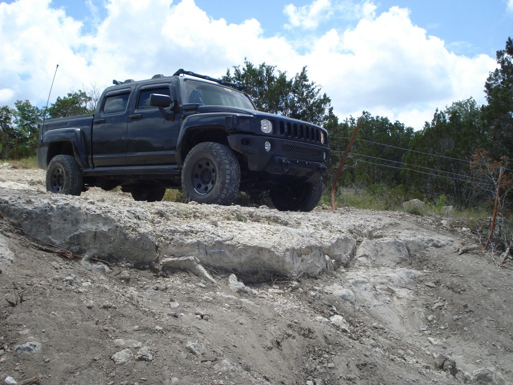

Those black wheels are sure as hell sweet, there are a few people with them for sell.
What light bars are these? I love them. Been looking for a set, was considering factory light bars, but couldn't find any that looked right. These are great, can you tell me where to find them?
Old Aug 31, 2012 | 08:50 PM
SolidJJ's Avatar
Joined: Jan 2010
Posts: 363
From: FT HOOD, TX
Sorry about the long wait, they are SMA roof light bars. I have a set on the front and rear the light output isn't the best but its better then nothing. They don't make then anymore and I've one seen one other set beside my own. In the near future I'll get a roof rack and a 40" LED light bar and post both the bars for sell. Just keep and eye open for the.
