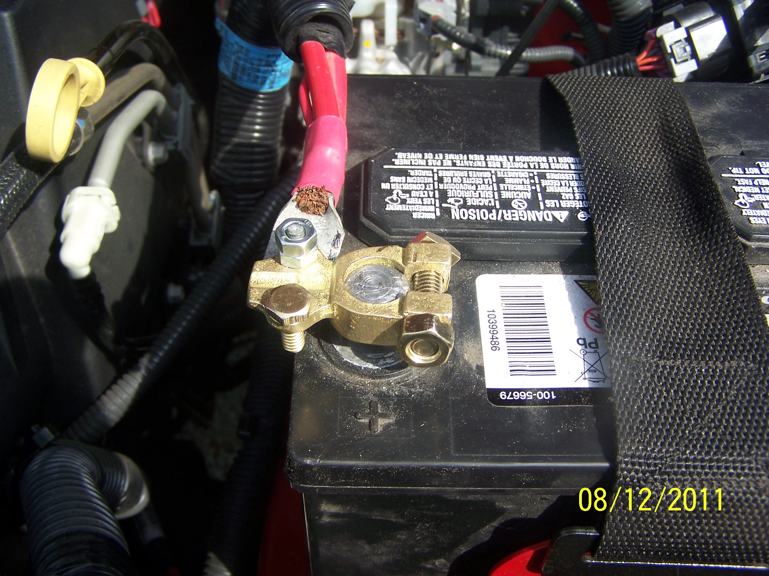

heres a solid way without loosing factory crimp. drill a hole in the factory clamp.cut off excess.
bolt it to solid brass. good for life.
actually the threaded stud was on the factory strap.use a nut to attach,rock solid.
