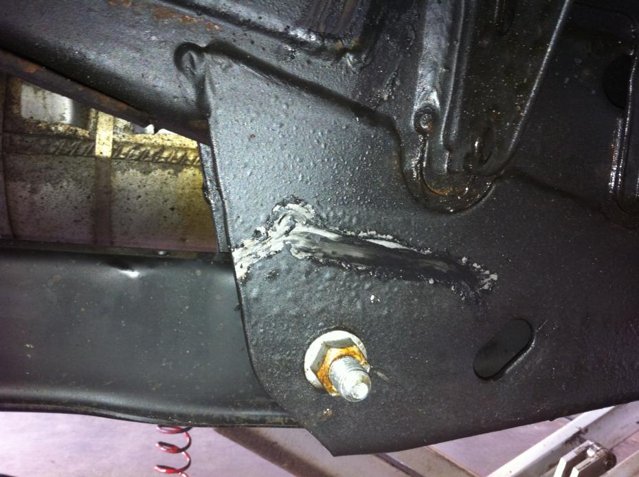

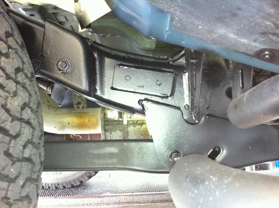

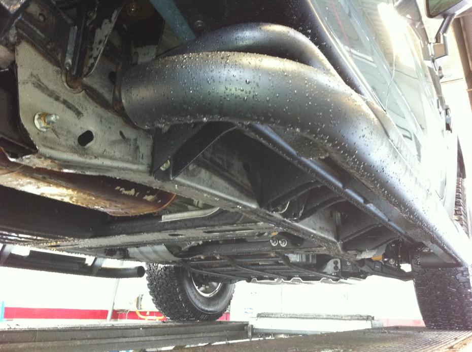

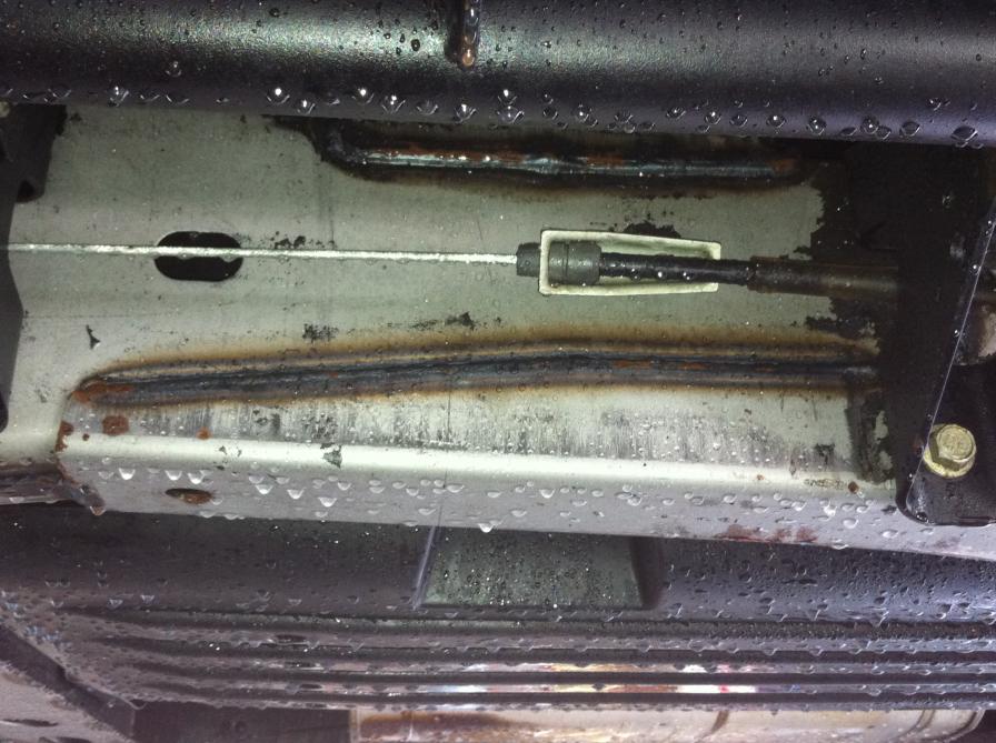

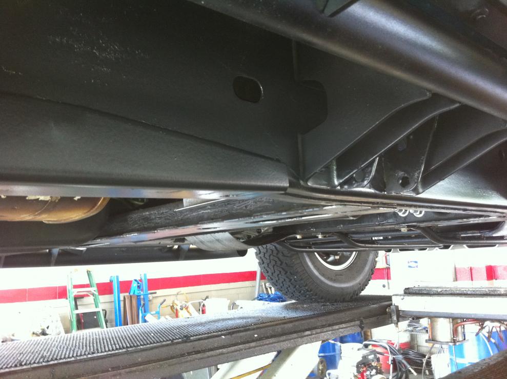

Here are some pics of the frame being prepped for re-paint. It was stripped using a garden hose.
