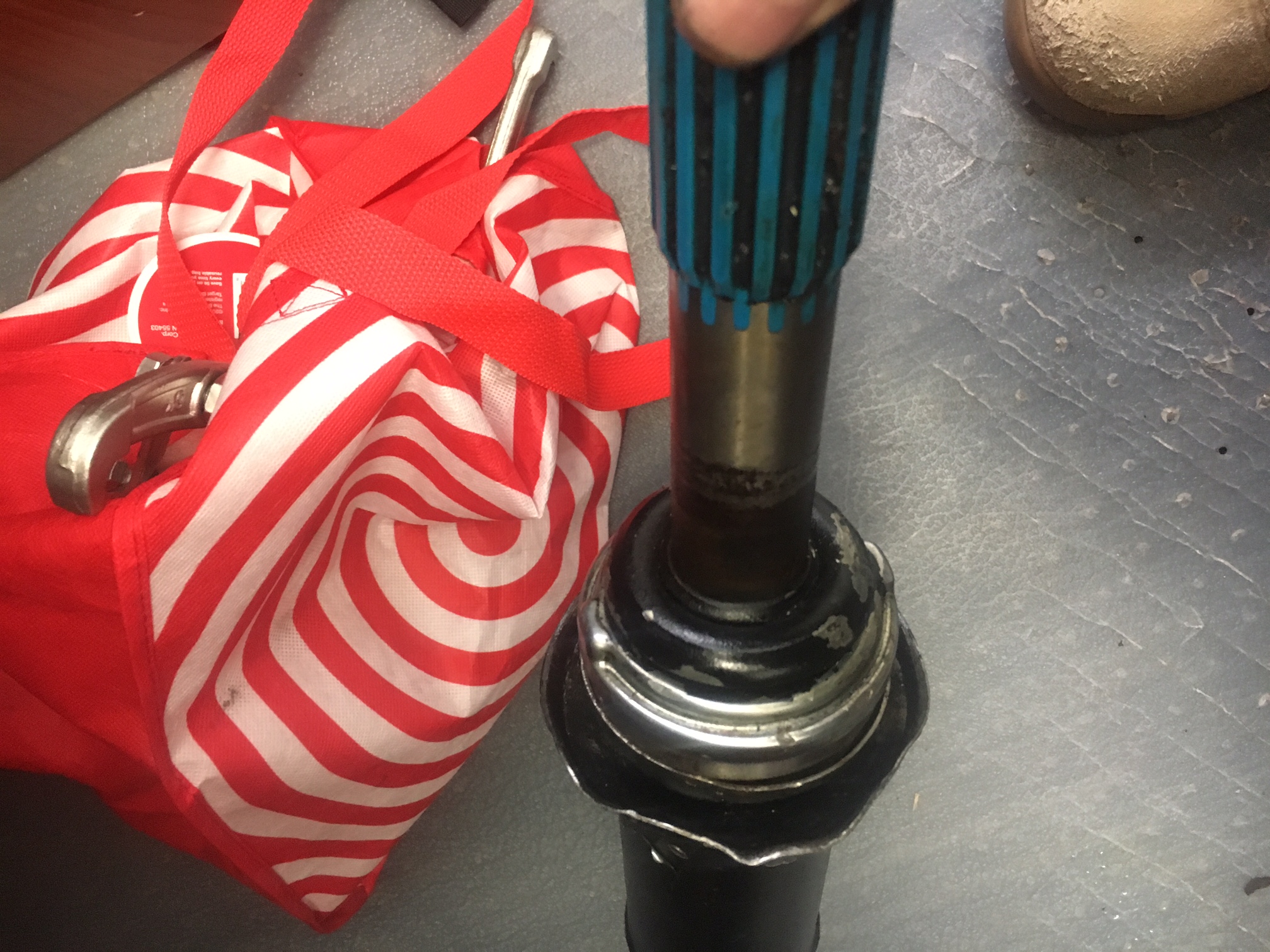

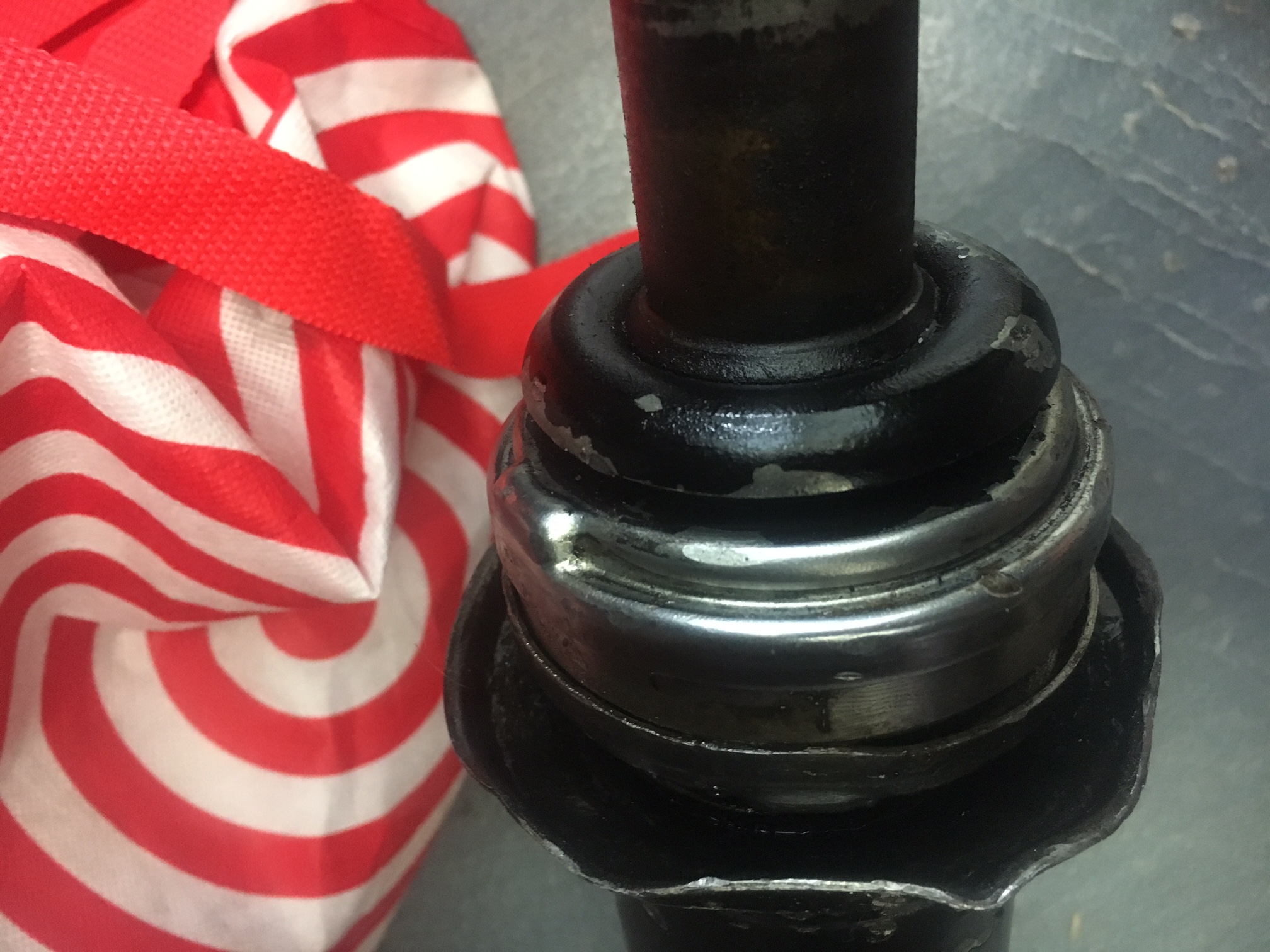

Default How to get center bearing off
3hummers thanks for the help with the belts.
Tackling a new job now. I am replacing the center bearing as mine is bad. I cant seem to figure out the damn retainer ring though. It does not seem like it will be big enough to even fit over the end of the splines on the shaft to take it off. What is the process here? I have a puller which really wasn't making the bearing budge. I then noticed the retainer just doesn't look like it will even come off, like its a part of the shaft or something. I added some pics of my progress which isn't much getting the darn thing off. Should it still just pry off?

Welp never mind I got it, boy was that sucker on there pretty hard
