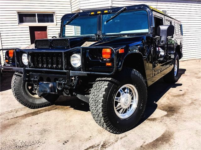

I am looking to purchase a 2001 Hummer H1 Turbo Diesel. Need some advice, thanks!
A few questions, how bad are repairs, people say its expensive and often but what does that mean, will the truck be in the shop every week, will it cost 1k 10k 20k to repair and maintain per year. Basically how bad can it get? I plan to put on maybe 5k a year max 10k. I would be taking it to my mechanic and not doing any work myself.
Another question, when purchasing what should I look for, what are the service records would this be found on the carproof report or the manual or some document that comes with the truck? If it does not have service records what should I be looking for?
Any help would be greatly appreciated, this will be a big purchase for me about 50k USD for the truck it has around 120K miles on it, not sure if thats good for pricing but i guess depends on the truck exteior and interior look mint, attached a picture.
Attached Thumbnails Buying a new Hummer H1 Repair and Maintenance Questions-wooly.jpg

How would I know if I have t bette engine not the bad one serial number is below2001*AM*GENERAL*HMCS VIN:*137ZA84371E193830 4*DOOR*WAGON/SPORT*UTILITY 6.5L*8*FI ALL*WHEEL*DRIVE Standard*Equipment*|*Safety*Options
Old Feb 27, 2016 | 11:00 PM
If you have E99 or later stamped on the right rear of the block you have an updated block. (F99, g99, etc ) if the 4th character in your VIN had been an F that would signify a GEP block which definitely would be a heavy or updated block. Yours is a Z so you need to check the mfg date code.
Old Feb 27, 2016 | 11:06 PM
Maintenance and repairs are dependent on condition and use. If you buy a truck that is current on both ongoing maintenance will not be bad. Many trucks are sold when the deferred maintenance has been neglected and the owner either has to spend a size able sum to get current or sell the truck. Have it checked by someone that knows Hummers. I do most of my own work. Labor rates for mechanics run about $135/hour here. That adds up. A major "C" service runs $1200-1500.00 and is done at 12,000 mile intervals. If you do it yourself it costs a couple of hundred dollars. The trucks are not that hard to work on. Repairs are on top of the service. I would estimate that I spend about $1000.00 per year per truck unless something major comes up.

thanks for the heads up,,,,,what about an aftermarket car starter would they be an issue? where should i look for rust? the truck is an east coast then canadian truck both areas with lots of snow/salt
in regards to pricing what i am looking at is a 2001 turbo diesel with 107,000 miles, car looked very clean exterior, underbody was decent too,,i will attach pictures later today,,,overall it looked good and owner is asking $46,000 usd
what would be a good price for something like this assuming it doenst need major repairs,,,,although the engine light was on but it seemed to drive fine

Bobby crawl under the truck. You will see real rust if it is there and a problem. 46K is a decent price for a 2001 with 107K on the clock. As Ian and I have suggested, if you don't know Hummers get someone that does to do a pre-purchase inspection for you. I have done dozens for people. Even if you have to pay someone it will be money well spent. Engine light could be anything from a sensor to......Have someone pull the code and tell us what it is.
