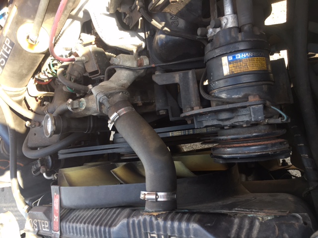

Previous Owner looks to have bypassed the AC Condenser although I don't think there is anything wrong with it. They bypassed it by using belts attached straight from water pump to alternator and fan to alternator. No belts are now attached to the condenser. Does anyone have a schematic or part number of the original belt that I can use to put on the Hummer to see if I can get the AC to work?

Thank you for the response. The condenser spins freely so not sure if that would alleviate it being locked up? How should I go ahead and run my serpentine belts? I have some pictures of how it is currently ran I will send shortly, I would like to get the belts back to stock rather than how they are now

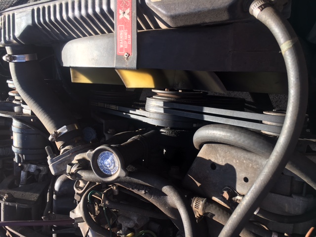

So here are the pics of how my belts are set up. Got two going from water pump to alternator, then two going from water pump to im assuming power steering pump. Is there a better way to route this? Should this all just be one serpentine belt to run each pulley? Again, I would like to get the AC hooked up to at least see if I can get it running correctly as it doesn't seem to have any disconnections or issues, may just need a R12 recharge.

My 92 has the twin belt set up but it covers the AC also. Really busy day. I will try to get you pictures and belt numbers tomorrow.

The transmission filter hanging down with the pan off a bit is ok. The trans pan hold it up. Sounds like the po short betlted it because the ac compressor ( not the condenser) is bad. The clutch may still turn but compressor is probably still bad. Try rolling the compresor by hand not the clutch.The problem when ac compressors fail and come apart is that it dumps a lot of metal ( aluminum ) into your hvac system. The syystem will need to be flushed out internally.

I was actually messing with it last night, the clutch spins freely and make a hissing noise in the back of the condenser upon rotation which I would think would be the noise of the frion being pushed into the system, but the belt pulley turns freely as well, it's worth a shot hooking it up and recharging it, I'm hoping the PO just didn't know it needed a recharge and disconnected it thinking it was bad. Anyone know what size belt it is and I'm assuming it routes straight to the water pump pulley?
