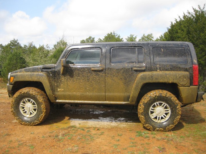

Bumpstops will fix the bounciness. Putting the new shocks on wont lift your ride anymore than it is. You should not go over 24" from center of the hub to fender lip when you crank your T-bars; past that you put a lot of stress on the CV's and tierods. Lift the rear all you want, but make sure your ABS cables have play in them for the rear and that the front is not over 24". The pic I posted has my truck at 23 7/8".

heres a pic... leveled with 35 MT's
Attached Thumbnails Lookin to lift...Anyone use Shackles?-24193_104015712961104_100000580272397_107960_4912537_n.jpg
