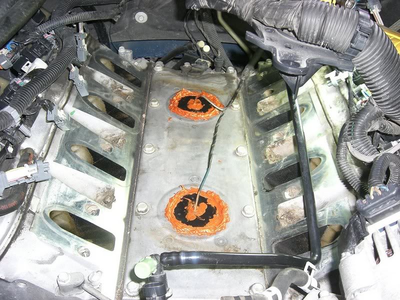

IMHO, knock sensors are fairly straight forward.
Just put some RTV on the "caps" when you re-install those to keep water, etc.

Id do it neater then this, because I am ****, but this is what I am talking about.
