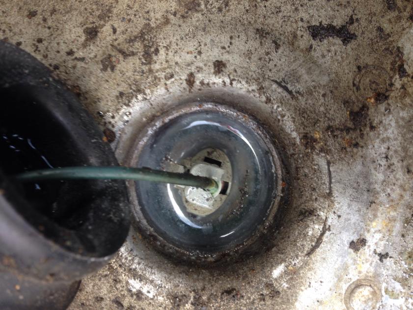

So with the intake removed this is what I found under the caps. It looks like silicone but that is water. In the front and back. Thanks for hosing my motor down!

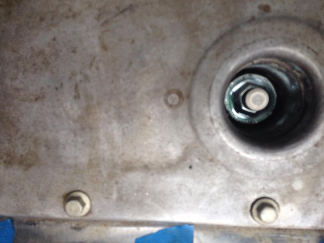

All cleaned up with new KS. Do not overtighten! Snug is good. Also added some dielectric grease to the connector.

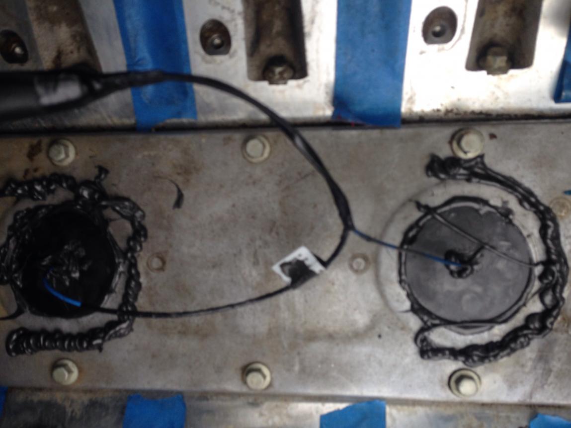

Some preventative measures

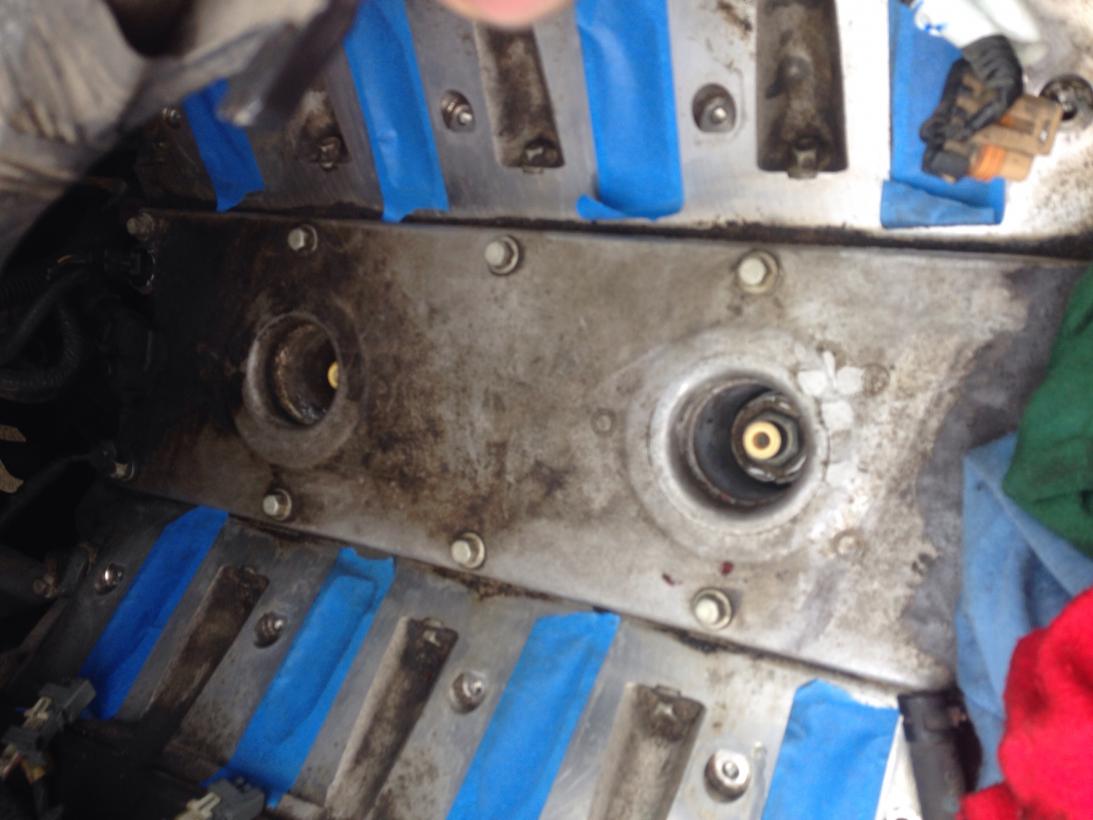

This is where they are

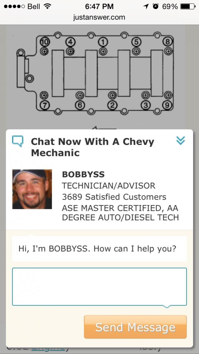

Now for the intake gaskets. Can't stress enough to buy the Fel pro steel set. Torque specs are 44in/first round 89 in/ final. Don't know if you'll be able to see the pic. I just screenshot it. Hope this helps someone. It's not too hard of a job. Just have to be patient and pay attention.
