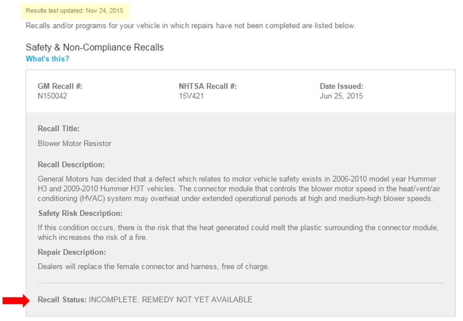

Originally Posted by choochmalooch
Not to drag an old thread through the mud ...but just how do these recall notices come out? I obviously bought my Hummer H3 used in 2013 and I have received nothing to date. I am currently not having any issues but I would really want to make sure the new parts are installed by the dealer.
You should call Hummer Customer Service and update your info with them, i.e. you're the new owner.
There are no redesigned new parts as of yet. I believe all of us have received at least the first letter, only.
Hummer Customer Service 1-866-486-6376
GM recall number N150042
NHTA campaign number 15V421

Posts: 77
No new parts yet...
