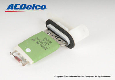

Unnecessarily overly sensationalized article title... but I'm sure more than a few here will appreciate the overdue attention that was needed from GM for the blower motor resistor issue. You can find them on eBay for ~$20-$30. It is part # 15-80647.
The problem is not fixed by just getting a new resistor module. If that's all you needed then you were lucky.
The problem is a loose connection in the connector between the resistor module and the wiring harness. The loose connection causes overheating of the harness, connector and module. The connector then melts and shorts out the resistor module which means that you loose the speed control. That's where the possible fire can occur. I've seen melted and burnt connectors.
The fix includes a new resistor module PLUS at least a new connector and maybe replacement of parts of the wiring harness.
