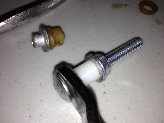

Default Quick $1.00 Fix
1) Remove shaft from transmission.
2) Grind off existing stud.
3) Drive out with a punch.
4) Insert 1/4"-20 carriage bolt (I had to round off the square flange under the carriage head).
5) Insert washer, nylon spacer, washer, nut.
6) Cut bolt to length.
7) Reinstall.
After being quoted $70 at the parts counter for the entire cable assembly I decided to fix this myself. I bought the nylon spacer at Lowes in the fasteners section. It has a 0.25" hole and the OD is 0.40". I recommend using a lock nut of some sort so it does not back out. I used the carriage bolt for clearance on the back side.
There is no real load on this assembly and what I did won't break in a couple of years.
Took me about an hour with simple hand tools.
Good luck!

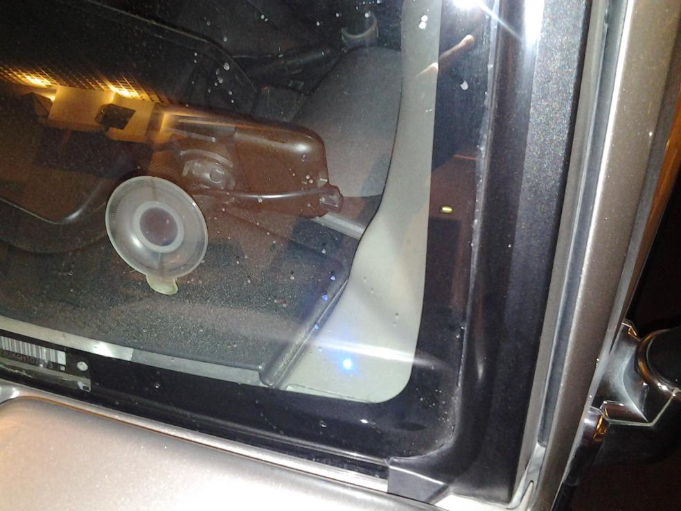

I;ve noticed BLUE LED on the left corner dash of driver side was blinking. It was never before...
I was in doubt what is that light means?... Does it contribute to why my H2 WONT start? But after sometimes the mechanic manage to start my H2 by doing "Direct Wired the STARTER RELAY

Can you take a picture of the blue LED and post? It sounds like an aftermarket alarm system indicator. My dash has no LED's.
Problem solved. Check my other thread here. https://www.hummerforums.com/forum/h...t-start-31464/
U can try the mentioned steps.Mine is from VIPER alarm. I think all aftermarket alarm system have VELET Switch located somewhere in the car(mine was in dash fuse box)
