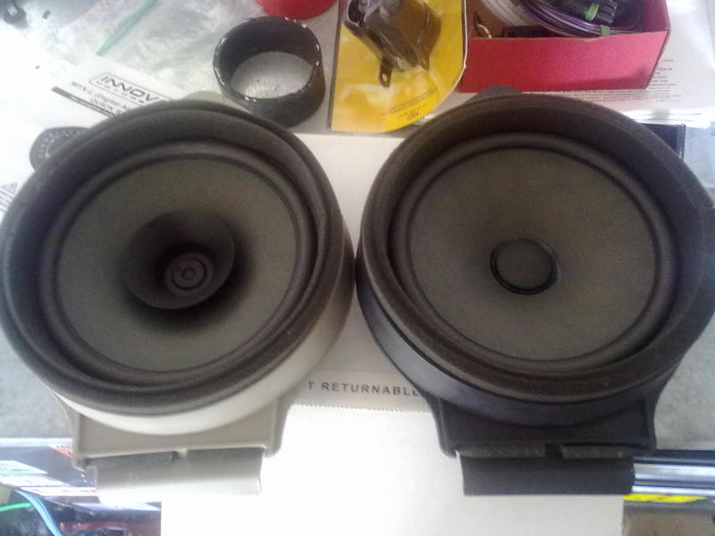

There will be no physical connection between the tweeter and door speakers as they would both run through a cross over only allowing certain frequencies to each speaker/tweeter, the door speaker would generally only get mid frequency sounds, while the tweeter will get the high frequency sounds and the sub gets low frequency sounds.
That is the point of having separate speakers, as it places the correct frequency sounds in the right location and to the right speaker, so if you have not rewired the whole system, it means your 3 way speaker would not be getting the frequency to work correctly as the manufacturer intended, as the cross over would be filtering out any low frequencies and any high frequencies before they get to your door speaker.

Aussie,
It sounds like you have a different system than mine. Mine is not an optional Monsoon system. I do NOT have a subwoofer. I'm also pretty sure there isn't any crossover connecting the door speakers and tweeters (though I've been wrong before!), but I do understand what your saying with regard to frequency separation. The head unit DOES have satellite radio and just a single CD player. Quite basic and primitive. I replaced the rear door speakers today and they are actually 2-way (at least they appear that way, as they are different from the front - see pic below).

Yes, the rear speakers should be 2 way so a 3 way replacement will be fine.
There has to be some sort of cross over for the front, as otherwise the tweeter would be destroyed in no time, unless the tweeters just have an inline frequency filter in the speaker wire (a cheap form of a cross over), unless they run directly off the head unit, not sure how it works but there has to be something that stops low frequency signals going to the tweeters.
The front speakers you fitted will work, but it would mainly be the main speaker part working.
