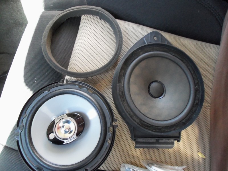

I bought these Kenwood KFC-1664S 6.5" speakers for around $35 shipped. Super-cheap!

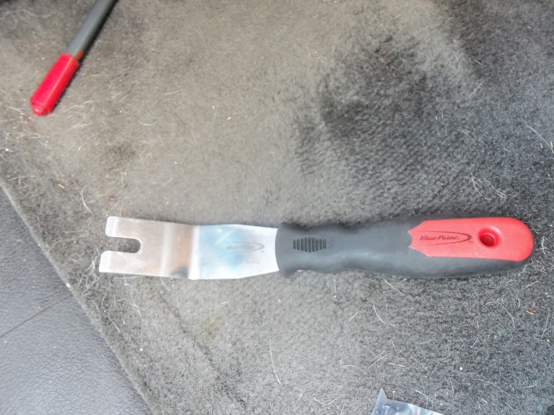

This tool (or similar) will come in handy when removing your door panels.

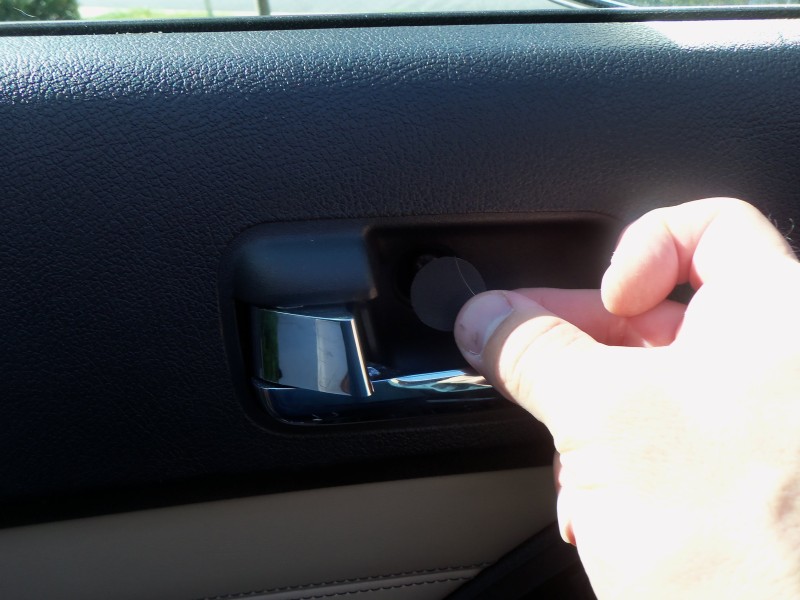

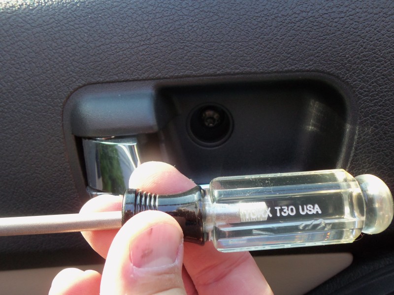

There are THREE torx head bolts that need to be removed. The first is behind a small plastic circle behind the inside door handle. It is easily popped off with a small screwdriver.
Use a torx head T30 to remove this and the other two bolts that will be shown in the next step.

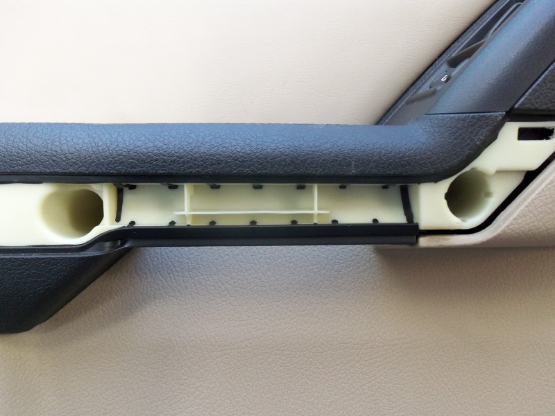

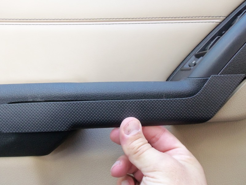

Again, using a small flathead screwdriver, pry off the trim piece on the door-pull handle as shown below.

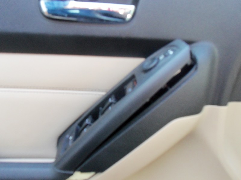

GENTLY pry up the trim panel that contains the window/mirror/door lock controls. It's easy to start at the front of the piece, as there are really only two main clips (at the ends) that retain it.

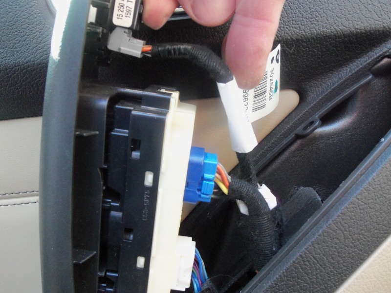

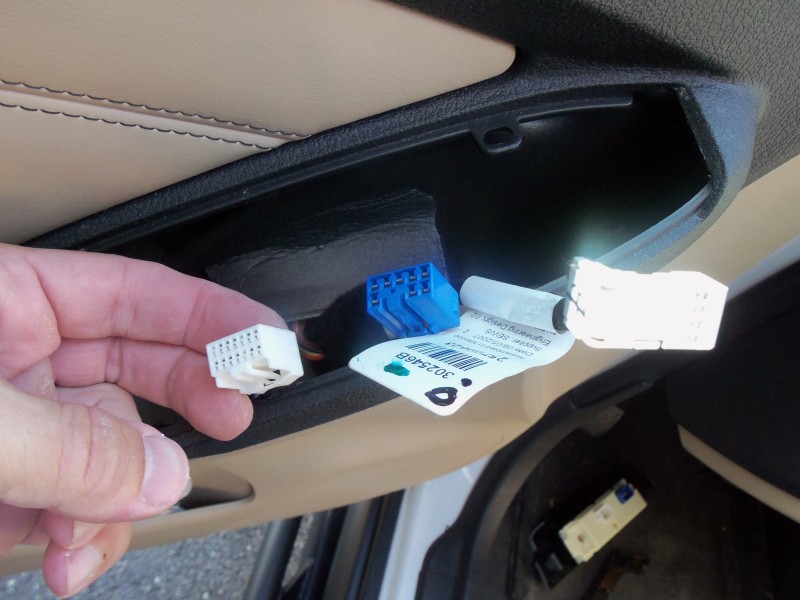

Once free, you'll see that there are 3 switch harnesses (gray, blue, and white) that need to be unclipped. If you look at them, you'll see how they are retained. There is a small type of spring clip that holds them in. DO NOT PULL ON THE WIRES TO TRY TO REMOVE THEM, and you are NOT removing the switches from the panel itself. See below.

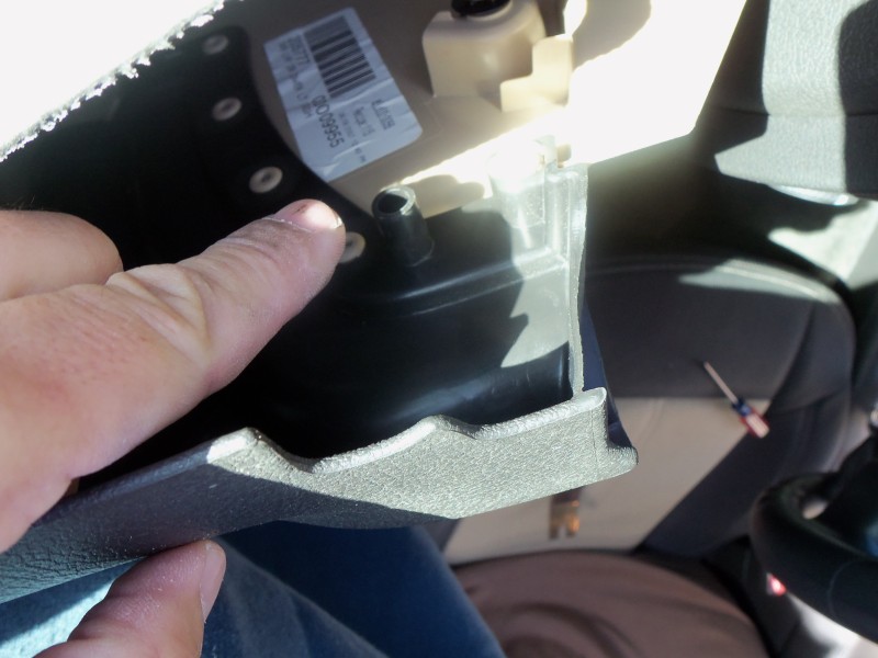

Next, you need to pry off the door panel, which is retained by several push-pin type of retainers that stay in the door itself and poke into the panel. Sorry, I forgot to take a pic of the inside of the panel to show, but you'll see once you pop it off using some sort of flat pry tool that is WIDE. I wouldn't use a screwdriver for fear of damaging the door panel, though I'm sure it can be done without doing so. I started prying the panel off at the bottom rear. It is held on pretty tight and it will sound like you broke something ("POP!") when the first retainer lets go, but keep going slowly around the edge of the entire panel until you feel it sort of hang free. Now gently LIFT the panel up off the lip that it's hanging by, but BEFORE removing it, there are TWO pushpin retainers, one on each end of the top of the panel that hold the moisture barrier/insulation material to the door panel. See where my finger is pointing below. Remove these.

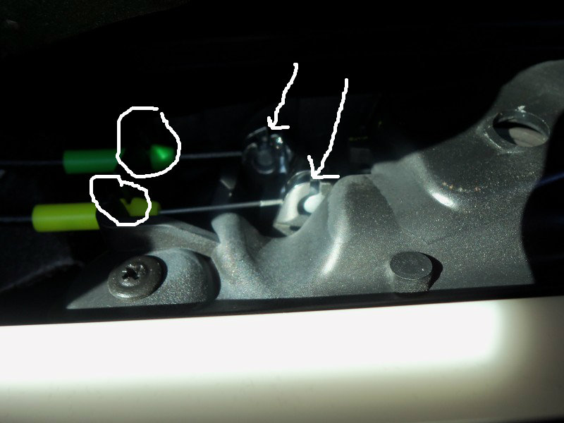

While holding the panel and NOT pulling it away yet from the door, push the three switches through the flap in the material, and also remove the two wires for the door handle/lock. These are the yellow and green things in the pic below. Pull them off the panel and pull the "ball" at the end of the wire out through the space.

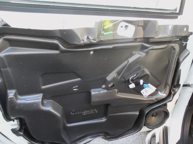

Once the panel is off, this is what it looks like.

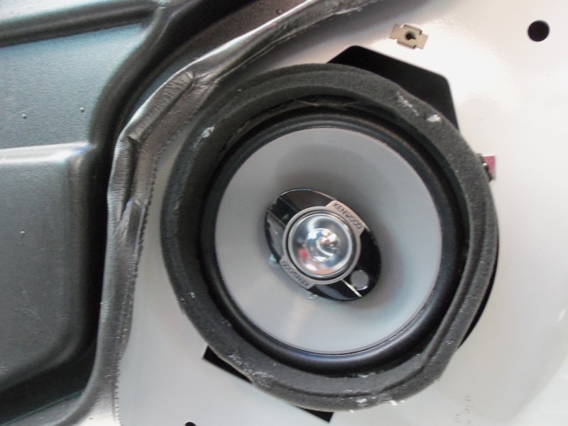

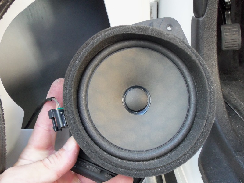

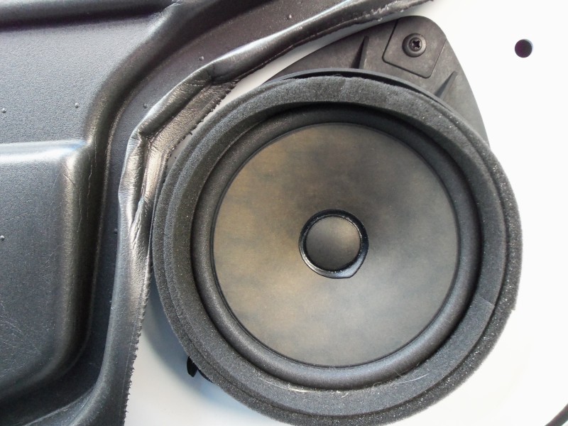

Remove single bolt holding speaker.
Remove harness on back of speaker.

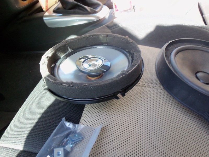

I cut off the foam ring around the stock speaker and glued it to the new one. Probably unecessary, but I hate rattles and had spray adhesive already.

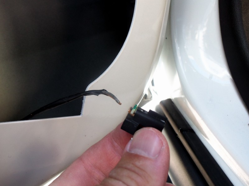

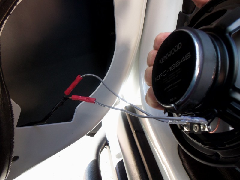

Cut off stock speaker harness end and splice in new speaker wire. Connect the other ends to the new speaker.Yes, I know it would be a cleaner installation if I soldered and heatshrunk the connections. TEST THE SPEAKER to make sure sound comes out!
