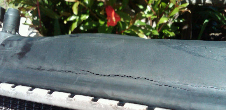

There are several threads about the top plastic radiator tanks cracking. It is a design flaw. Some people try to get the dealer to replace them. I opted to just have mine rebuilt locally with new tanks.
Here is the thread with the most info...
https://www.hummerforums.com/forum/h...-leaked-21184/
Here is a picture someone posted showing the crack everyone is getting. Not all are as pronounced as this one. I was chasing a mystery leak for months because the crack was too small to see.
