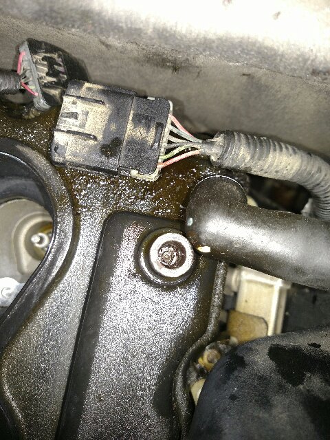

One thing I found that is not right. The Orifice someone spoke of earlier (happythree) It is completely stopped up. I put a hose on it and you can blow or suck any air through it. In fact looking down into it, it doesn't even look like it has a hole to speak of. The other side blows freely.
Why the hell would they not have a regular replaceable PCV Valve?
I dont know if this is the source of the oil but it cant be right. It will build pressure if it cant vent.

Default Orifice
I slipped a piece of heater hose on it and blew as hard as I could and put suction on it and got nothing. I even ran a little pressure from the air compressor to see if it would do anything. Just blew the hose off as if it were completely blocked.
Its an odd system that's for sure.
She is due for an oil change anyway. I might soak it in something and see if it will loosen up.
I am still trying to wrap my head around this causing the coil cells to have oil in them. I can believe all 5 O-rings failed at the same time without some cause.
Both of those hoses go into the same valve cover if one were stopped up, wouldn't it just blow more out of the other one. The passenger side hose is free as can be! Like blowing into a water hose.
Oh well, I will let you guys know what else I find.
If anyone has a thought please speak up!

Had to leave a little brake cleaner soaking in the orifice to unclog it. It was stopped up solid! Due for oil change anyway! It is literally less than 3/32"
Re-Torqued the valve cover, replaced with new plugs and hoses, cleaned oil off coil packs. Put her all back together and she runs like a champ again.
Will wait a couple weeks and see if they are still leaking.
