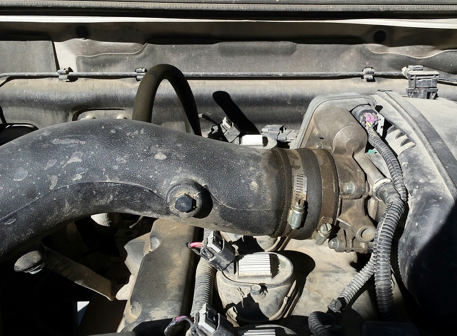

Here you go.
As you can see in the pic, the coupler and connecting hose are both covered in oil.

air from air filter goes to the air baffle or the kn device, thru the hose connected there to the head,down thru the crancase and up thru the tubing going to the intake where vacume is higher. its a one way trip thru a small orfice on the head top. thats the only way air can get in there.
most pcv is at idle where the throttle is closed.
there is no valve. i read this here years ago by ??
i dont see oil escaping in a vacume system, a leak would let air in, not oil out,
rings, blowby,??. still hard to figure how it gets out where you have it.??
