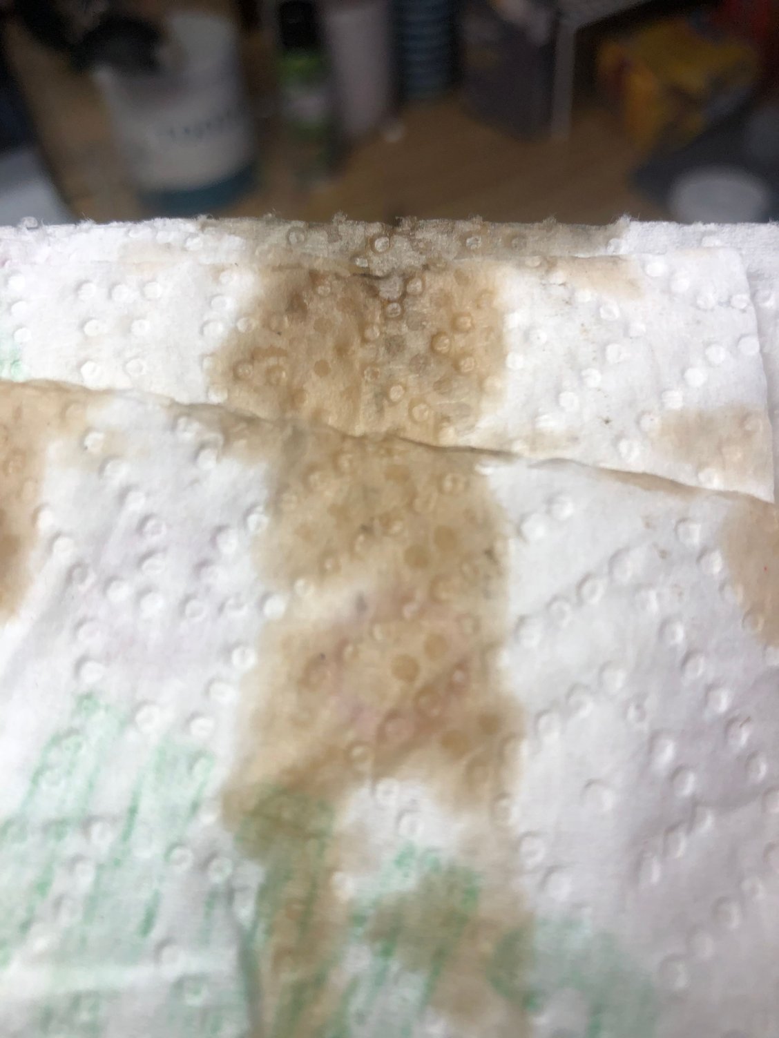

Check fluids and look for metallic flakes.
Pull the trans dipstick and wipe on a white paper towel and post picture.
After that,drain the fluid at the front differential and post a picture:

Trans definitely needs flushed, however that is not your problem. Did you drain the fluid in the front diff and transfer case?
