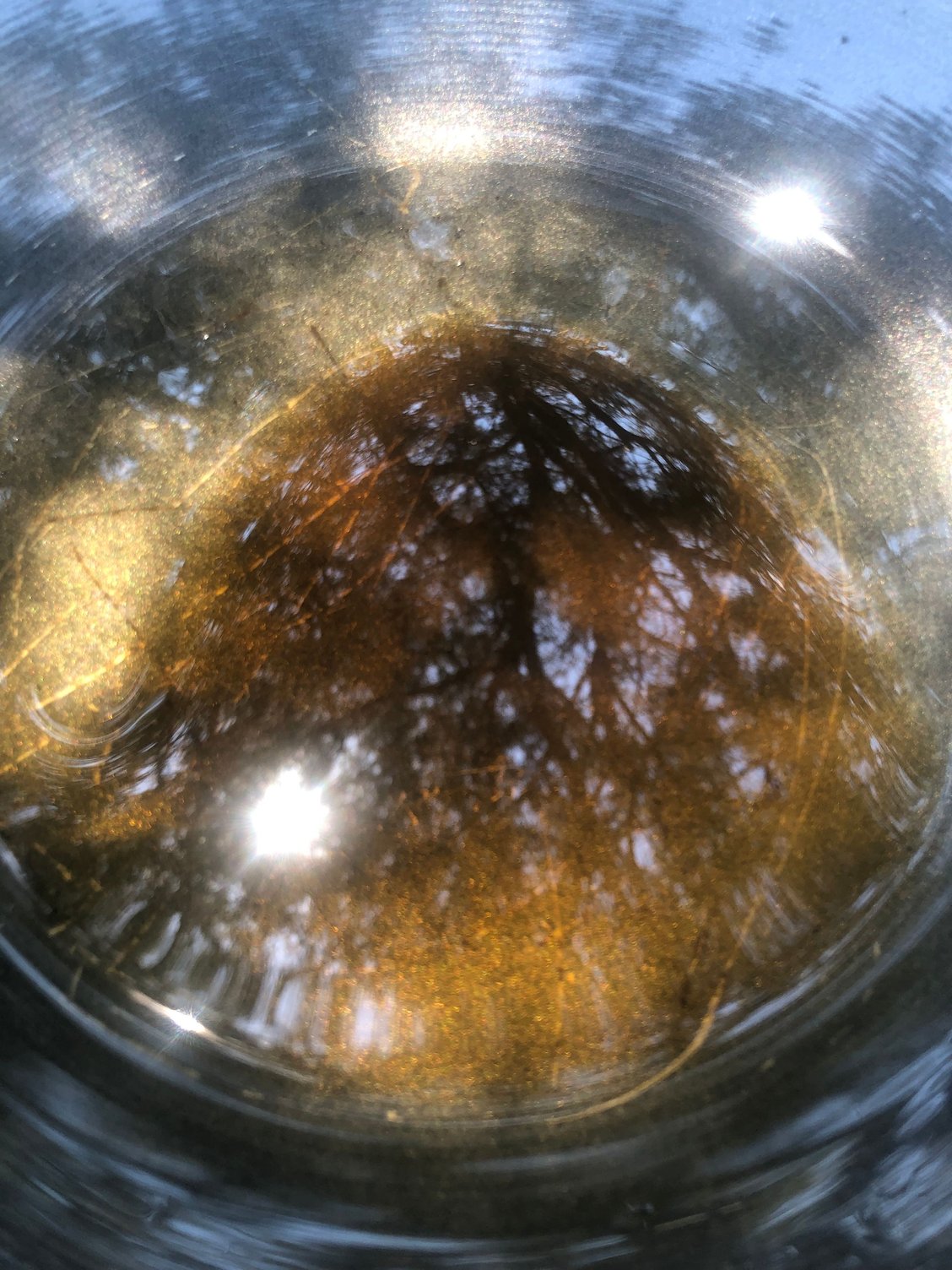

i Didn’t find any metal flakes or chunks in the differential oil! I drained it all then slowly poured most of it off til I got to the bottom of the pan and it was clean.

I can't make out your picture. Looks like a pile of dogshlt? Use a stick magnet and see if anything attracts to it. If all good, check the fluid on the transfer case. Btw get some fresh fluid in the front diff. I recommend royal purple maxgear.

Yeah that was the only thing I had to put the oil in. My neighbor helped me check it for metal but it didn’t have any in it.
