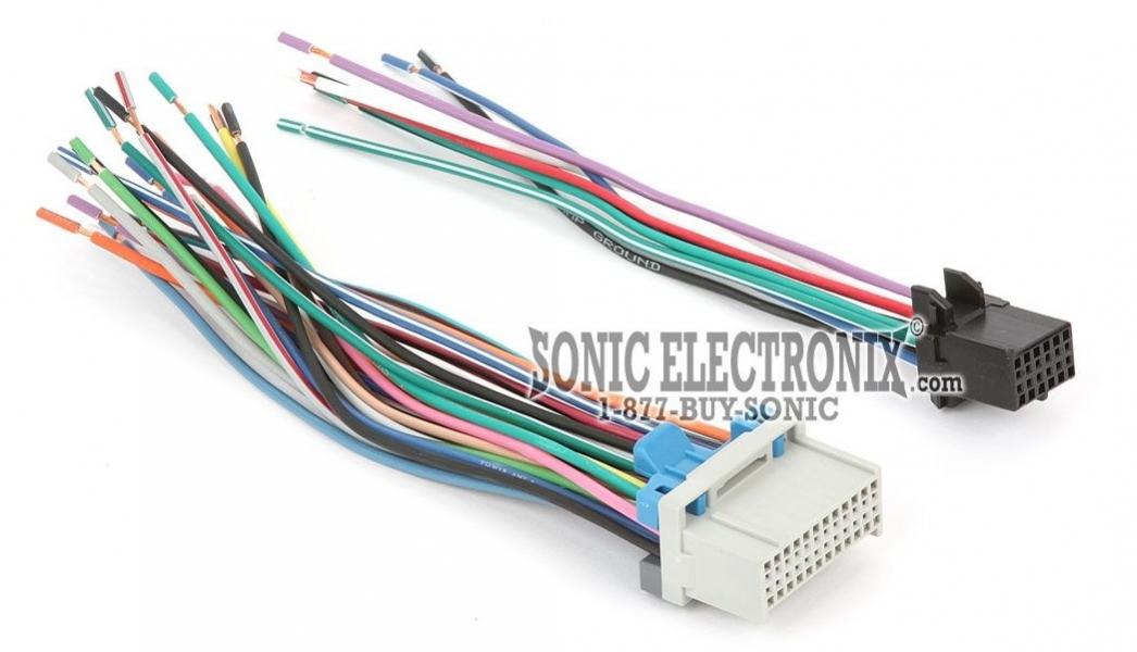

1- how and from where do I pull the brushed aluminium cover, it seems to be fixed with some kind of adhesive? does it fit back easily.
You pull the brushed aluminum cover from the bottom. Most of us stick our fingers into the two 12V ports at the bottom and give a pull. This releases the clips from the bottom.
Then you can grab the sides of the panel and pull to unclip the rest of the clips. There is no adhesive, just metal retaining clips.
2-"Unclip harness from connectors." which harness and connectors? I thought the connectors are at the back of the head unit.
The harness is the actual wires and the male connector is attached to them and you unplug the connector from the female connector which is attached to the unit back. One connector is grey and the other is black. These are the only two you need to add the carbon conductive grease. They just unplug from unit in back. All the connectors are on the back of the unit.
3-can I apply grease in all connectors? or just the two main?
No, I just added grease to the two connectors (one black and one grey) Like I stated earlier
Below is a picture of the two connectors that get the grease.
Remember to go back and check the original instructions for applying grease
Your PM is turned off or I would have contacted you that way
