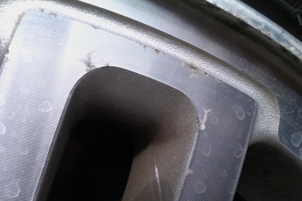

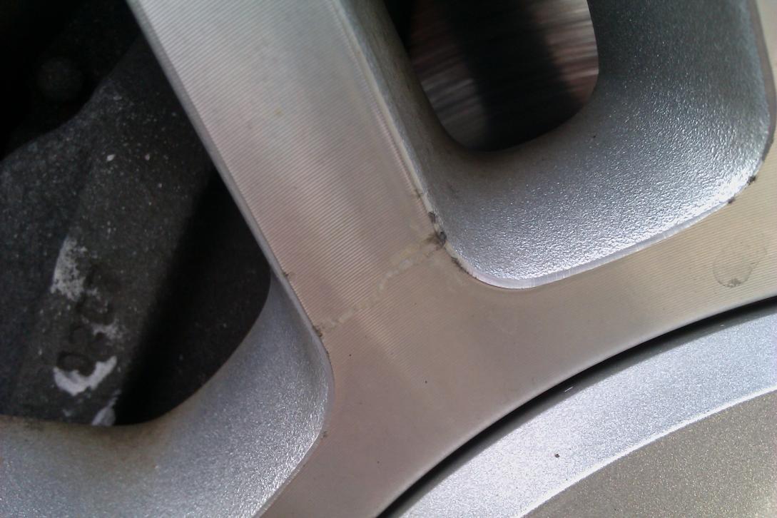

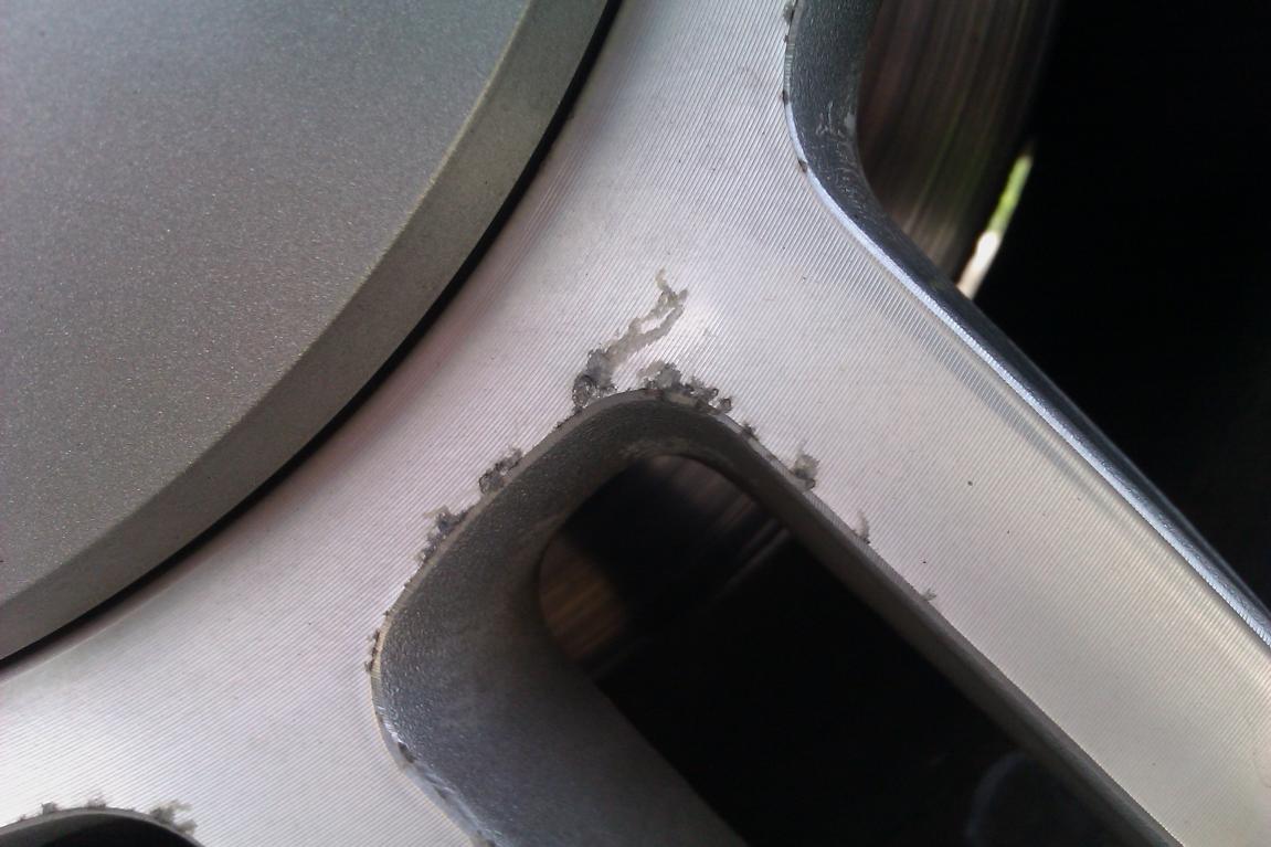

As for the rims. I attached a picture of my current factory rims with the oxidizing problem. I know it looks like it has started due to scratching but they have never touched a curb or anything that would cause imperfections to them. I dont know if its worth me going in and seeing what they can do or just wait it out and notify them right before my warranty is up.

The rims you have do have Filiform Corrosion. I would take it to the dealership to get redone. When I took mine in, the service tech took pictures and had sent them to the manager. Then I waited for a response and the word was that it is a warrantable repair and Gm normally has them re-machined not replaced.
Once repaired they will look brand new.
