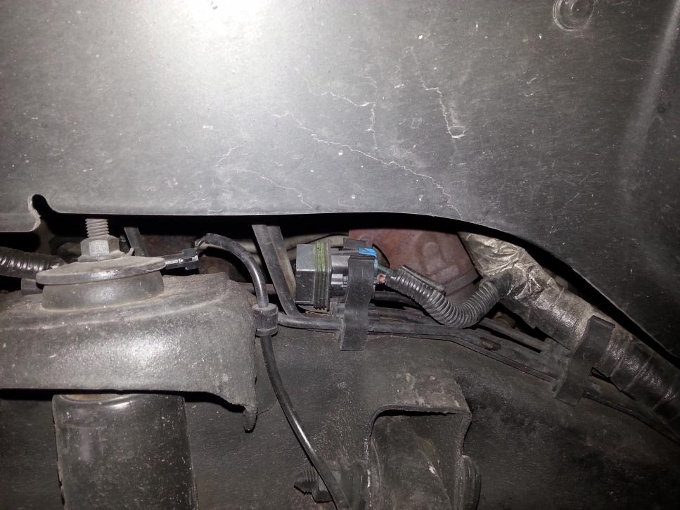

1. in the drivers front wheel well behind shock tower on the upper frame rail there is a harness plug pic attached what is this for...

1. The harness plug that you show in the picture goes to a relay that controls the rear suspension compressor. The earlier H2's used a compressor that inflated 2 rear air bags that lifted the back part of the H2. Later models changed from the air bags to a spring system. This alleviated the issues of dry rotted air bags, leaking air lines, or a burned out compressor. When the button was pushed on the dash to lift the rear suspension, that relay supplied the power to the compressor to begin inflating the air bags to the desired height if you were towing a trailer etc.

Thank you for the help! I was chasing the harness looking for the place to plug in the light bar.... when I found the unpluged air ride harness ... much appreciated
