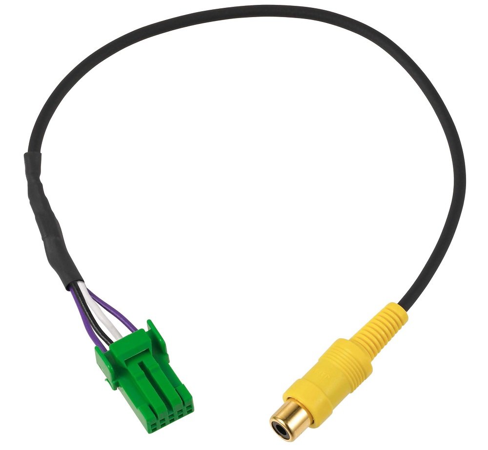

Is this what you're looking for?

I was about to buy That same wire but Im not sure the camera/screen is compatible with the LCD aftermarket unit
So most possible it wont works after connect to the aftermarket unit .
Cruchfield shows the wire as it wont works with aftermarket ..

If you plan to use the factory backup camera with the aftermarket stereo screen this works
If you want to use the lcd screen in the rearview mirror im not sure what you could do. Axxess AX-ADGM01 Interface Harness Connect a new car stereo to select 2006-up General Motors vehicles (retains Bluetooth, warning chimes, Retained Accessory Power, and OnStar) at Crutchfield.com
