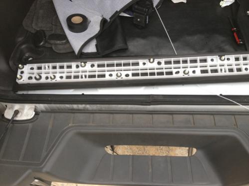

I am looking at putting in a backup camera on my H3. I went with the Audiovox camera (recommended by crutchfield). I will be connecting the camera to my Pioneer AVH-p3200bt. I have searched for all the write ups on back up cameras and figured that I would just run it to my reverse lights for power. However, I cannot find anything on how to run the wire from the stereo to the camera. Therefore, my question is how do I run the wires from the stereo to the outside of the vehicle? Is there a certain hole that I should look for that I will be able to feed the wire through? Is it better to go through the driver or passenger side? And last question does anyone have pics of where to feed the wire through? Thanks and I appreciate the info.

I ran the backup camera video and (+) power cable (wired to the reverse signal output) from my Pioneer Appradio/Metra Harness. The camera grounded itself when I mounted it to the bumper.
I routed the wires from behind the dash to drivers side, along the bottom of the kick panels, sidetrim, to the back gate then through two holes behind (driver side rear corner) - see attached pic. The wire come out between the rear drivers side wheelwell/bumper. There is a black plastic plug/cover that you will need to remove/re-install once you run the wires through. be sure to use a grommet or cut a notch for the wires so you can re-install the plug properly.
FYI, you will need to remove the plastic sill cover see (pics below)of the rear door (the one that says HUMMER) before you can partially pull away the left rear side compartment to get to the holes.

Thanks for all the info and pics. The pics are extremely helpful. I am going to give it a shot.
