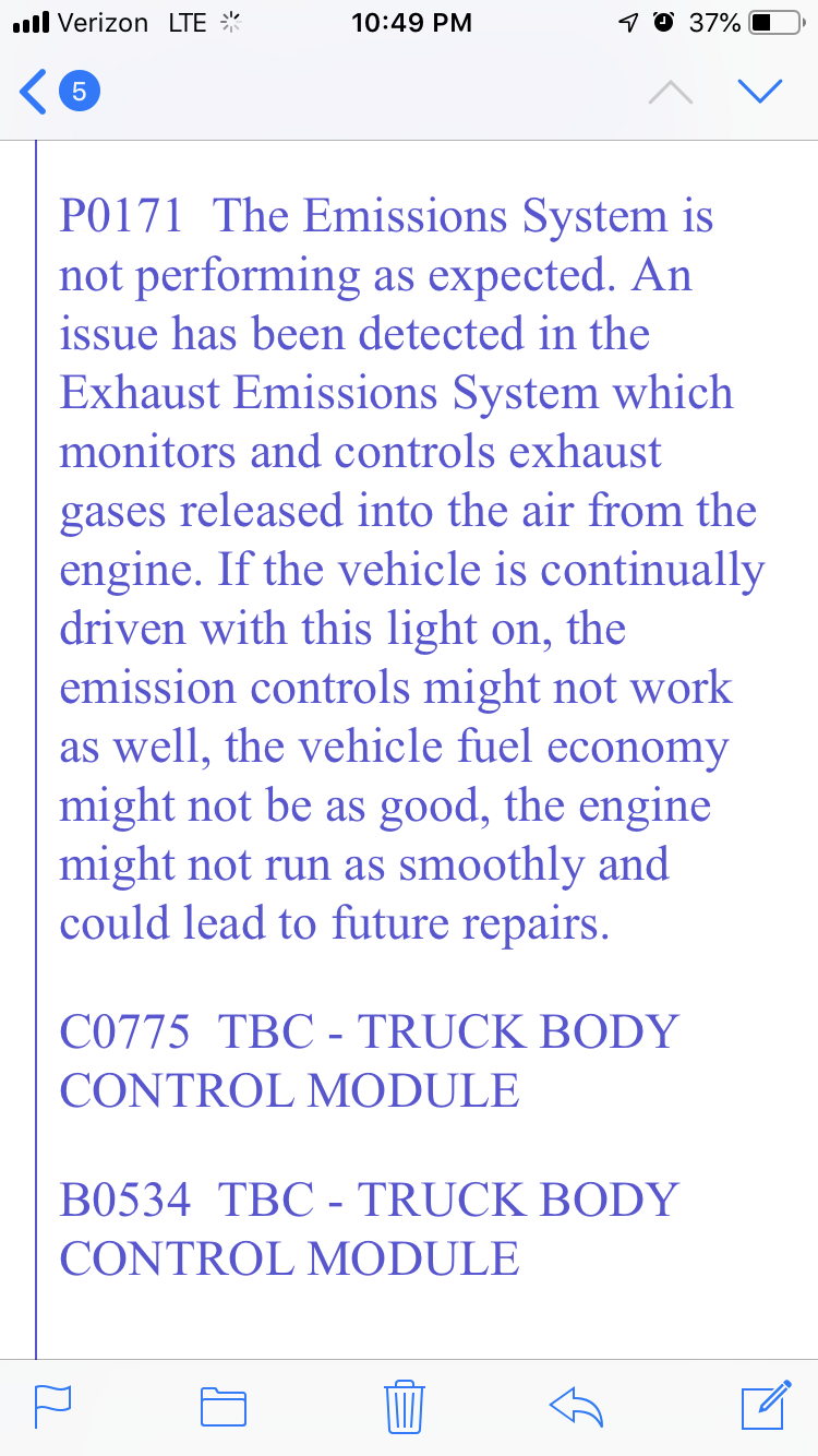

i called onstar as soon as I noticed my engine light on. They emailed me the codes and this is what they read. Please can someone tell me if the TBC has anything to do with the P0171 code or is that a seperate issue? I think I get this same code every time something is wrong with the truck. My truck is 2006 H3 and has 240,000 miles but I love it. I have another car but want to keep the truck because it is a classic. Is this problem going to be expensive?

I would start with some easy stuff. When was the last time your Throttle Body was cleaned? When was the last time your MAF sensor was cleaned? When was the last time your Air Filter was changed? When was the last time the spark plugs were changed?

Your sunroof is leaking because of clogged drain tubes. Read this on the fix, Google it as well, maybe your son can do "the fix" on that problem. Finally, a fix for clogged sunroof drain tubes
The sunroof does not need repair, the drain tubes need the fix.
When the sunroof leaks, the water comes down the passenger side A pillar to the floor. The vehicle BCM (Body Control Module) is mounted behind the kick plate of the passenger side and it does NOT like to get wet. When water leaks in from clogged sunroof drains, it gets the BCM wet. Important to get the drain tubes fixed before any further electrical issues develop. That is the root cause for your C0775 and B0354 codes.
