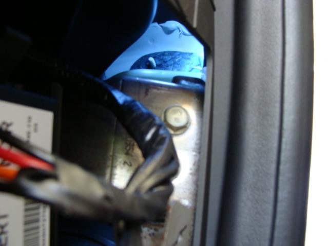

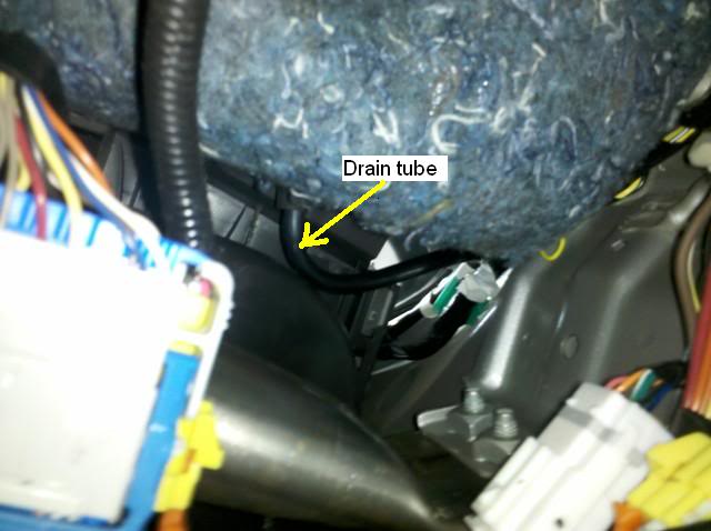

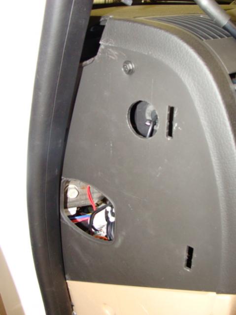

I've been lucky, and haven't had a problem yet, but didn't want to wait until I had a drenched interior before I found a fix. The drains are rubber hoses that come from the sunroof, and then plug into rigid plastic tubing behind the driver's and passenger side 'A' pillar trim panels. The rigid tubing is shaped to follow contours behind the instrument panel, where it then plugs into a rubber grommet that goes through the firewall and drains behind the wheel well inner panels. This whole fix is done entirely from the interior of the truck. Start by removing the instrument, side trim panels, and the 'A' pillar trim panels (a phillips screw behind the 'Air Bag' trim plug...also unplug the tweeter so you can remove the panel) (pic's 1-4). I've included a pic from HUMMERZ, showing the location of the grommet behind the tach (pic 5). Reach up behind the tach, and unplug the grommet from the firewall. On passenger side reach through side panel, over the top of the steel support brace (pic 6), and unplug from the firewall. The driver's side hose is black, and goes into black tubing, the passenger side hose is black, and goes into white tubing. The hose is held with tape onto green retainers (pic 3). Carefully cut the tape from the 2 lower retainers on each side with an X-acto so the hose, tube and grommet can be pulled out (pic 7). CAUTION!! WHEN PULLING HOSE, TUBING AND GROMMET THROUGH 'A' PILLAR, BE SURE TO ONLY BEND/FLEX THE RUBBER HOSE, NOT THE RIGID PLASTIC TUBING!! SAME THING WHEN REINSTALLING!! The grommet can be pulled off the end of the tubing (pic 8). Look in the end of the grommet, and you'll see why the tubes get clogged. There's a molded in 'cross cut' that traps even small debris (pic 9). Take an X-acto and carefully cut that piece out (pic 10), and replace grommet on tube. Take some electrical tape, and tape the grommet to the tube to be sure it doesn't come off during re-installation (pic 11). Plug grommets back into holes in firewall, replace trim panels, and you should not have anymore leak problems. It probably took me longer to write this thread and take pics then the entire job took.

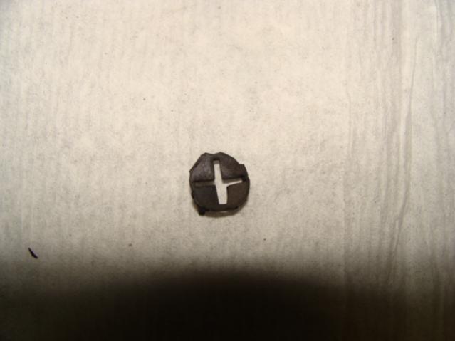

Update- I just went out a did the fronts as Broken Halo described, only I used a 3/8" drill bit that I ran through the grommet which removed the x-shaped flaps but did not harm the rest of the opening. By removing the X, you can now insert the rigid tubing past the grommet and hanging into the firewall itself.
