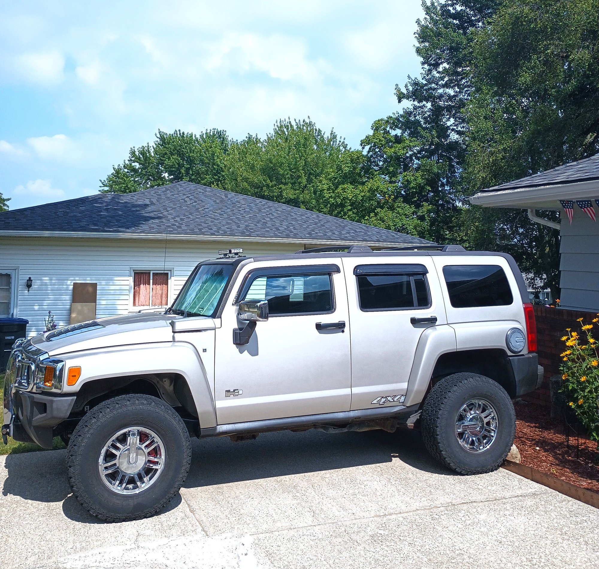

Recently my Hummer H3 Sunroof has been leaking onto the floor and it was discovered that a drain tube had come loose.
