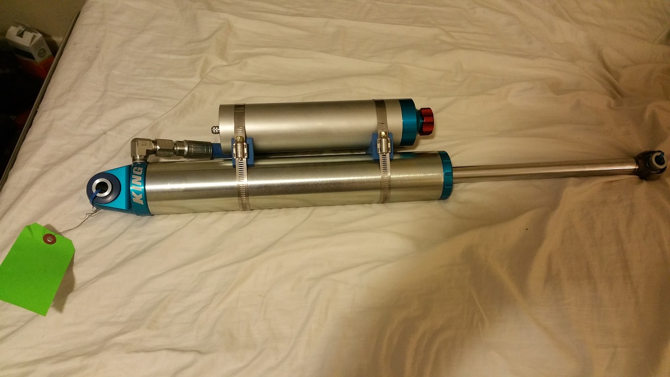

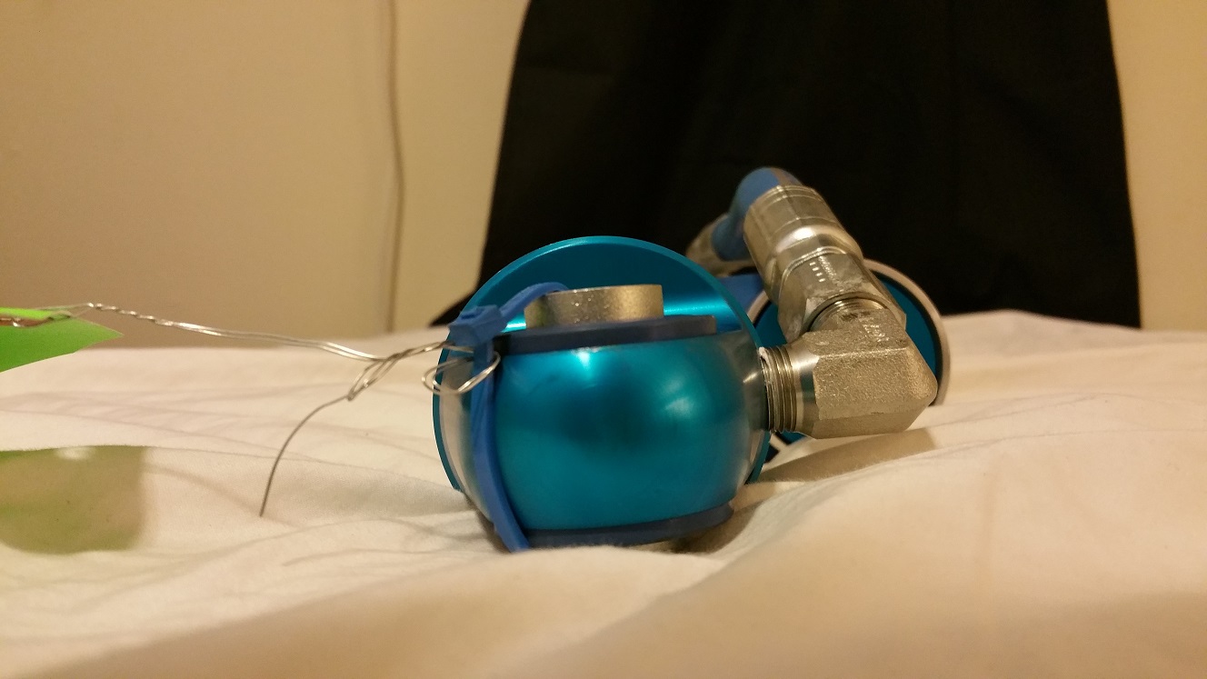

Shocks themselves:
Each shock is labeled left or right. There's no question which shock goes on which side. Each label states the build (stock or non-stock w/ model it's based on & what is custom). Very thorough here.
Here's some pics:

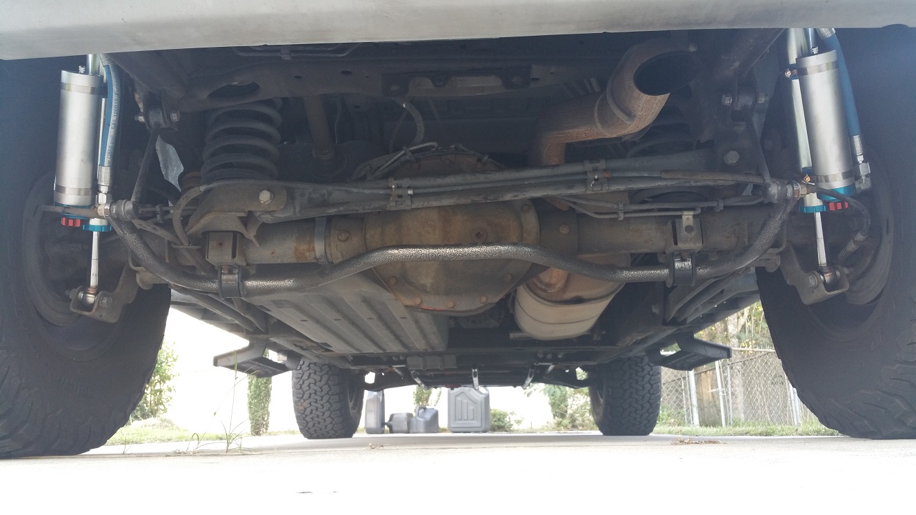

Here's pics of them installed:

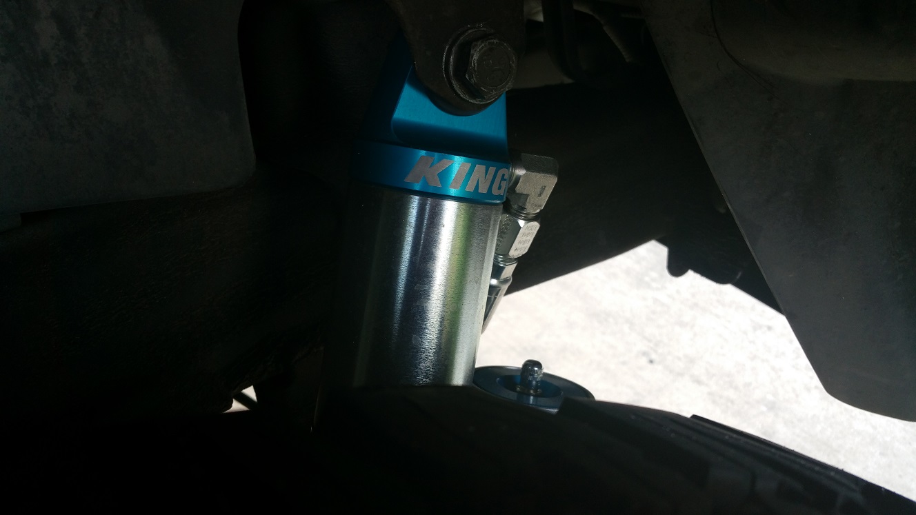

Left Side:

I was hoping the tubing would be internal on each side so that it wouldn't have a chance to make contact w/ the tire or anything thrown by the tire. I doubt it'll make a difference, but I expect a little bit better for the cost.
Regarding the price, these set me back a cool $1134.00. I feel for the price, I can be a little **** about quality. These are not $100 dollars per shock.
I am currently running both front & rears on the firmest setting. I will further adjust them to find the best quality ride once I get other suspension components replaced & take all of the jaring/shaking out of the my vehicle.
So far, they have fixed major jars & bumps with the vehicle. The fitmit was tight w/ the break lines, but in general, still fit extremely well & the install was a breeze.

Here is a shot of the original, stock rear shocks provided by King
These run about $780+ & can also be revalved, but are not adjustable. You can add an adjuster later on, but it will set you back more than the 1134 total I paid, due to extra labor.
The only difference between my version & stock is that now that the resevoir was strapped to the main body as opposed to the top billet mount. The sharder valve was moved to the top for easy access & the adjustment **** was moved to the bottom.
The **** loction is a pain as you have to crawl under the vehicle to change it. If they had switched locations, you'd have easy access from the wheel well.

Just curious, did you mean Schrader Valve..
