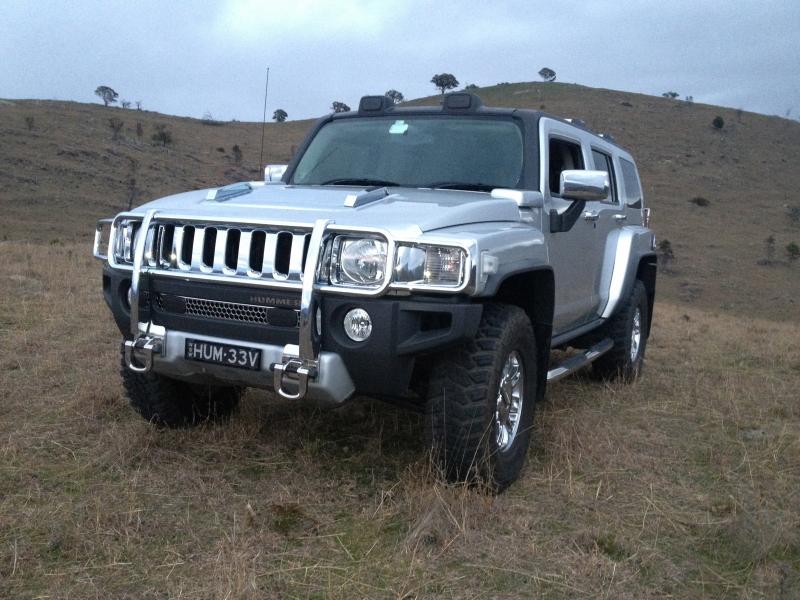

Had a couple of hours today so completed all engine bay wiring for both the grill lights and roof lights, installed wiring into fuse box, and fitted relays, so engine bay is all done
Also removed interior radio trim panel and fitted switches for lights, all that is now required to do is connect the interior wiring for the switches. But I will need to customise the wiring slightly to make it street legal here in Australia. I will wire them so that they will only receive power when the high beams are on, and the grill and roof lights turn off as soon as the high beams are dipped.
This will make them street legal for road use over here, so the power supply for the switches will be run through a separate relay activated by the high beam switch.
PS here are some photos taken on my last trip last week with the lights fitted, not great quality but photos none the less, was exploring a property I was considering buying when the photos were taken, ended up deciding against this particular block (260 acres) too hilly for what I wanted it for:
