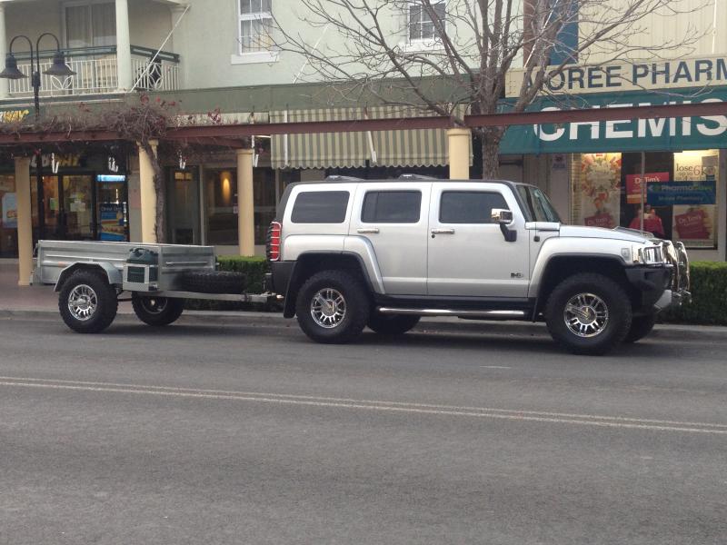

Have competed the air bag install, can't wait to do some towing now.
The air bags can easily raise the rear past 25", however I have decided the tow height to be 23.5", and the front will ride at 22.5".
Will have to now complete my trailer suspension set up, as I now know what height my H3 will ride at regardless of load, the trailer is riding a bit high at the moment giving it a funny rake.
You can sort of see it here, but it is actually worse in real life, the front of the trailer running down hill to meet the tow bar so will lower the trailer slightly so it sits perfectly level with a 23.5" rear ride height:
