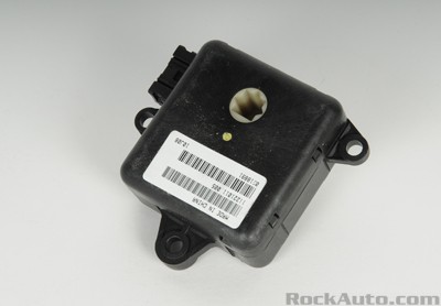

After changing battery in my h3 every thing is working but i cannot switch the air of ac up or dawn to feet or facing.
Also a noise is comming from a black devise (sensor) under the steering wheel
Can somebody tell me whats the name of that device !

sensor? or motorized vent? air flow is controlled by computerized motors with rotary feeback sensors to tell the computer where it is. can we say overkill!!

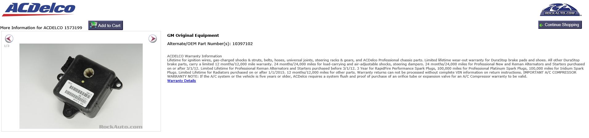

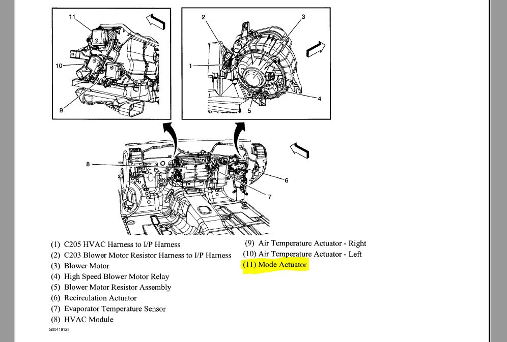

It is the mode actuator that Controls which vents the air comes out of, ACDelco #1573199 or GM#10397102 .

Khaled thanks for the best answer, I have already disconnected the mode actuator, COS THEY ARE MAKING A NOISE ( the white circle in the middle is not turning), and at the same time every thing is working fine even the AC is perfect.
