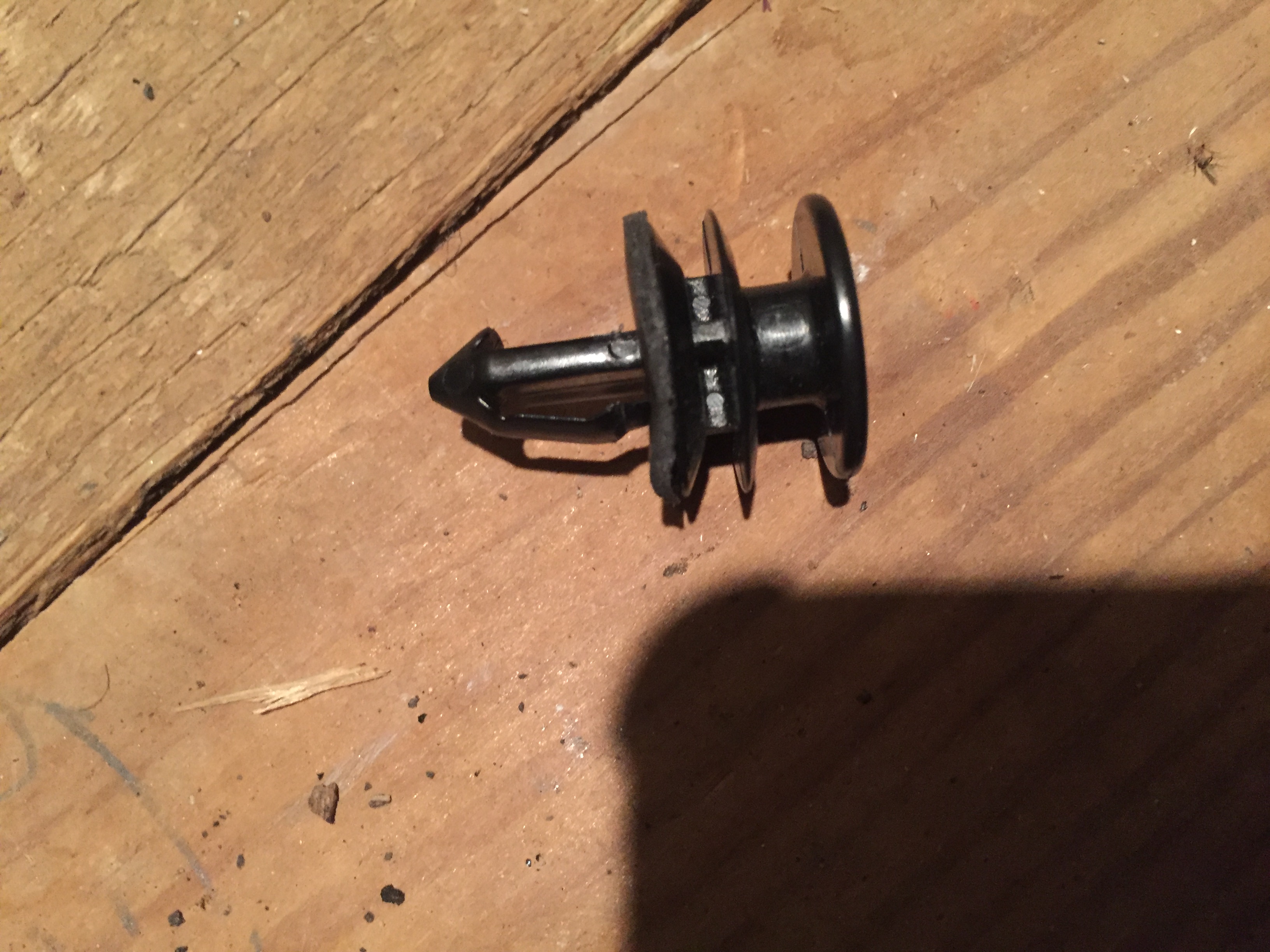

The black fastener in the first pic is one of the contributors to noisy door panels.
Notice one of the sides is missing.

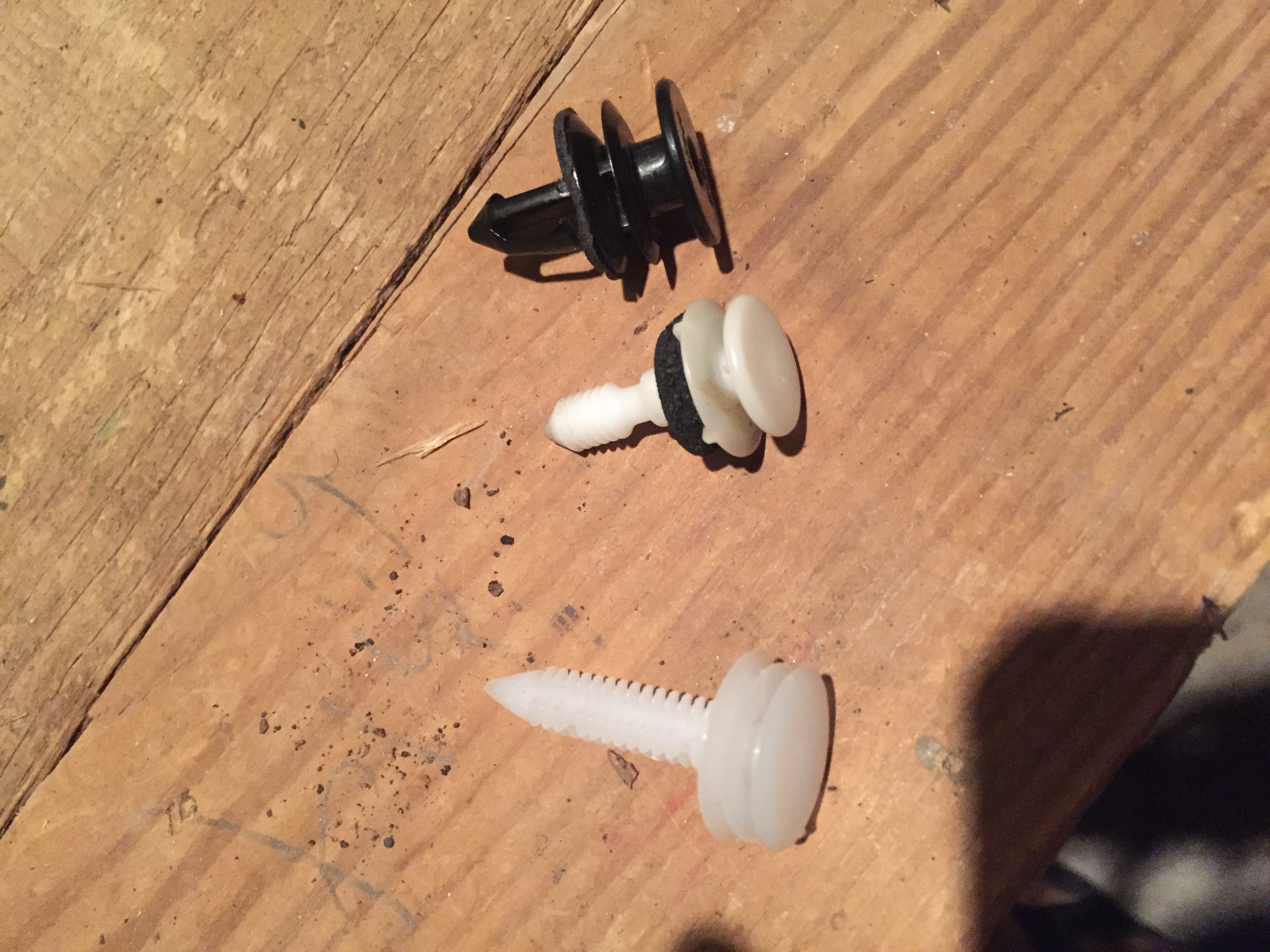

These fasteners are intermingled along with the white middle fastener in the second pic. These black fasteners were used to adhere the top section of the door panel. Given their age and length, they were no longer holding the top section of the door panel fastened to the metal door frame. This section would flap/bounce as I drove around.
As of yesterday, driver's side was repaired. As of tonight, passenger's side.
One additional comment about the fasteners I used, the bottom white fastner in the second pic. The fasteners' diameter was a bit small/narrow. I used masking tape to make their diameter larger and keep them inserted in metal door frame.
