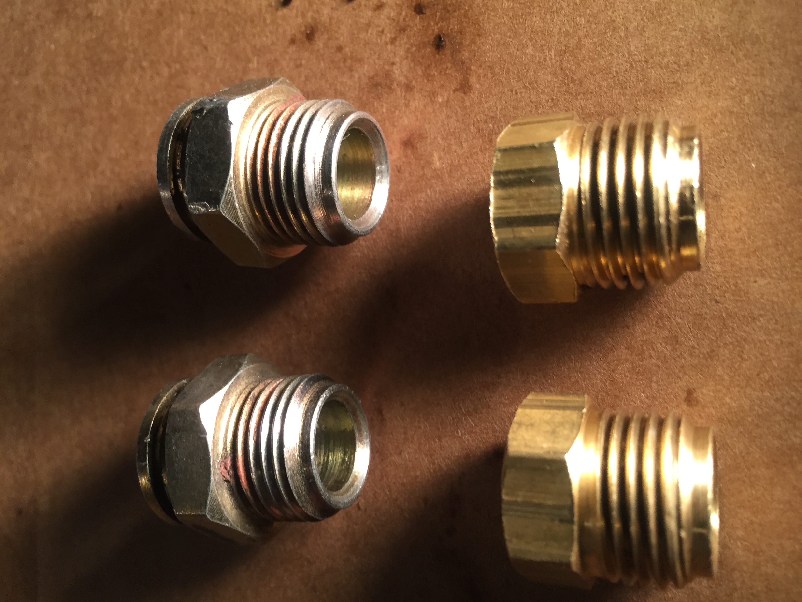

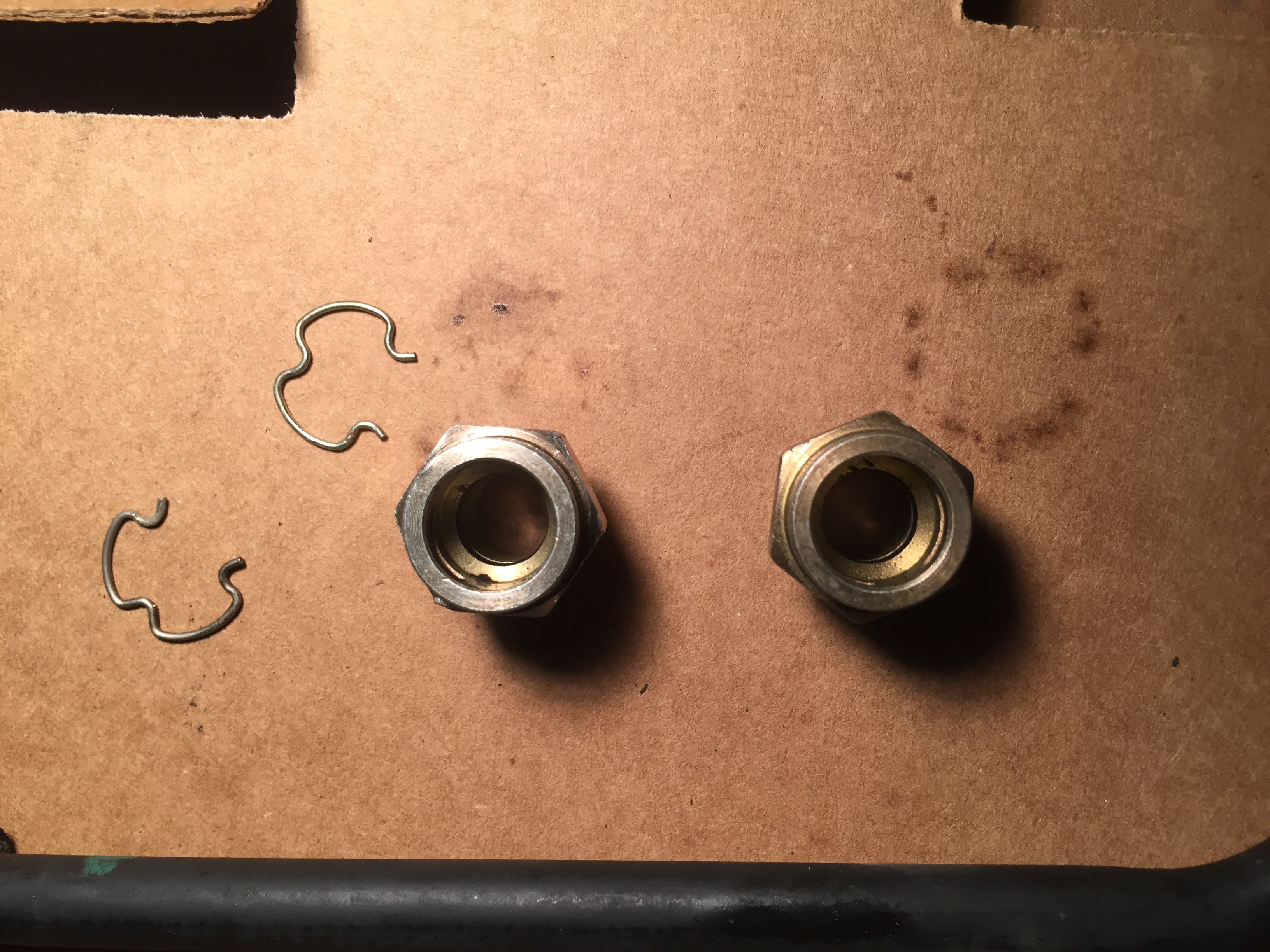

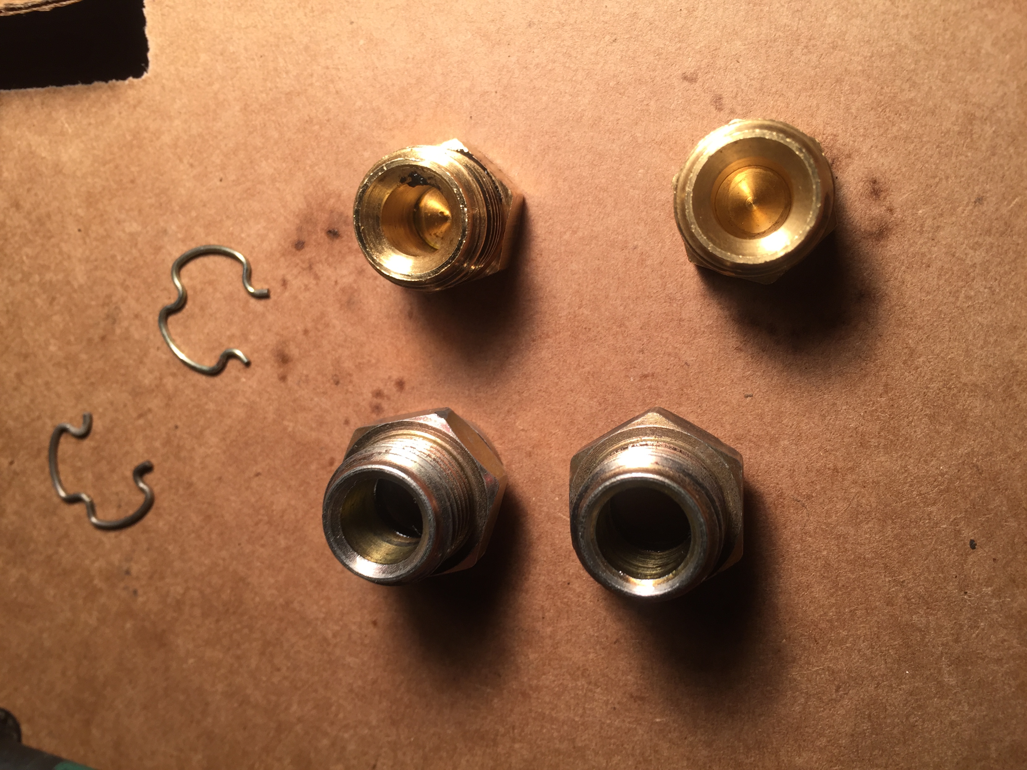

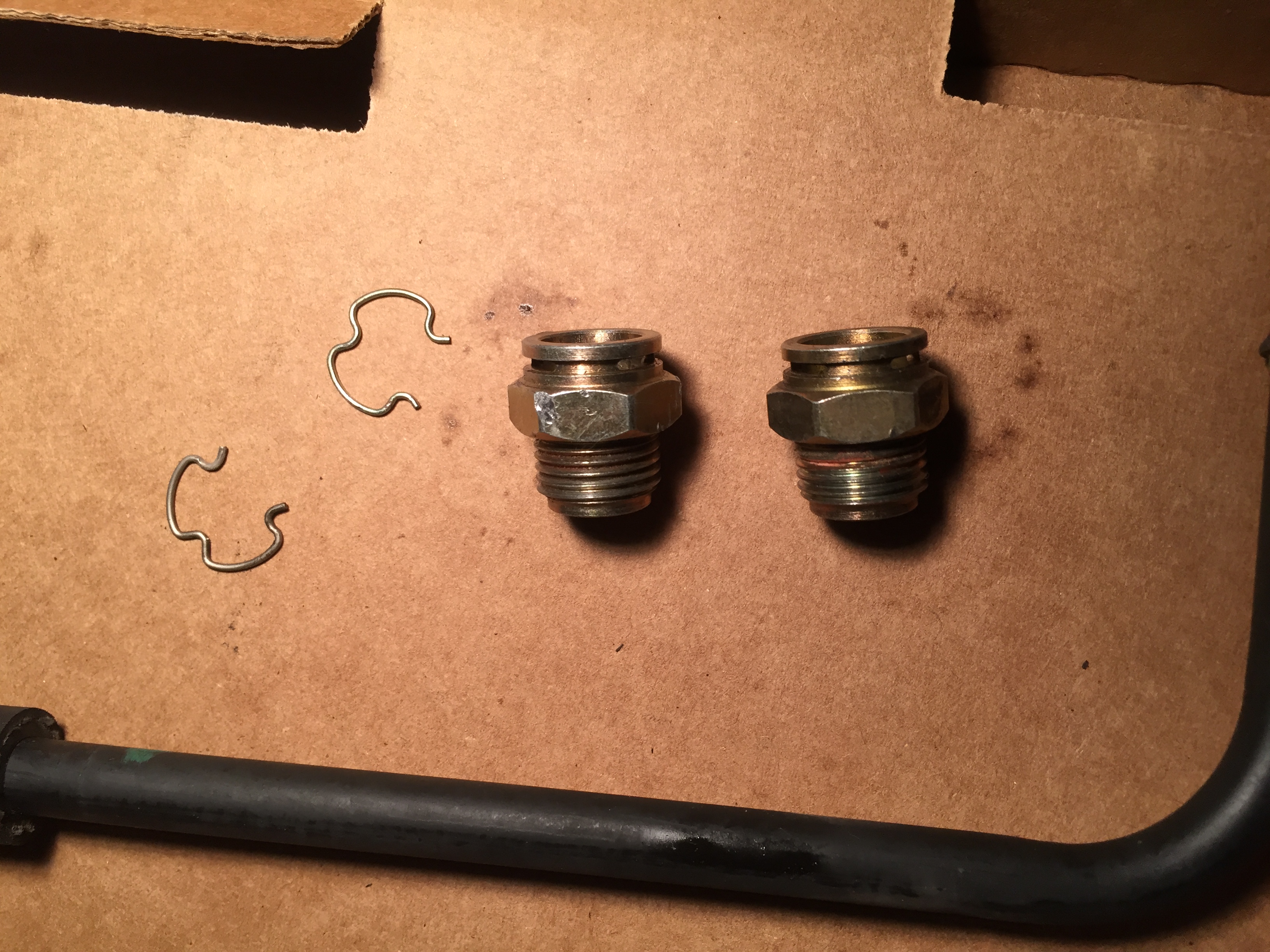

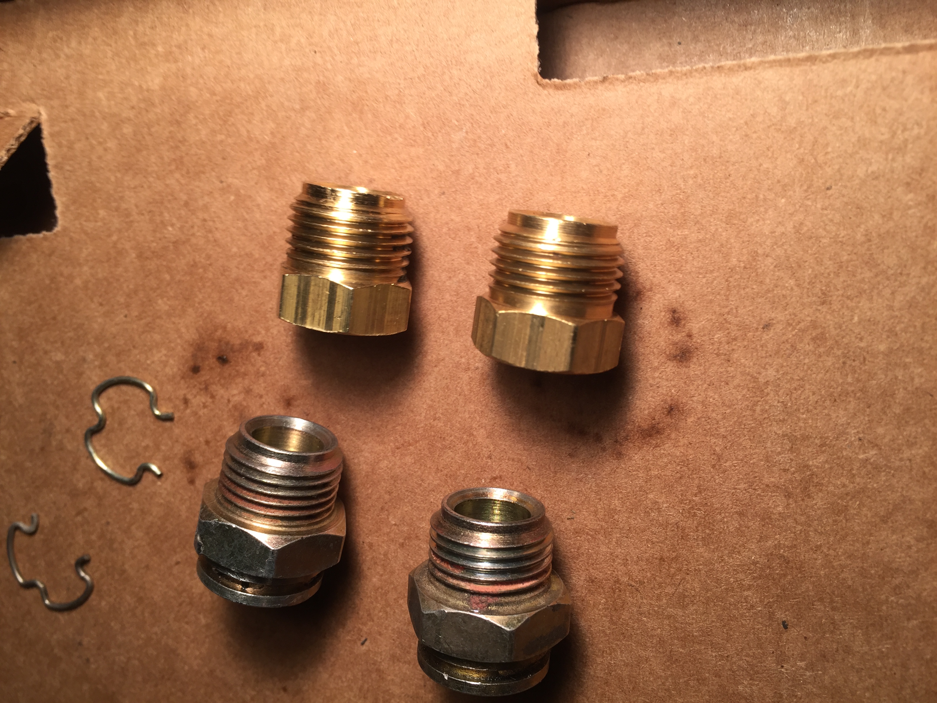

Default Details about transmission cooler line plugs
Well, after a week or searching high and low and after purchasing 3 different sets of plugs, I finally found/bought the correct ones.
The lines that connect at the top and bottom of the radiator on the passenger side go into quick disconnect fittings. I removed these fittings. The bottom one did not have any locktite left on it while the top one did have locktite on probably 25% of its threads. They were not hard to remove. Bottom was easy. Top required a medium effort nudge. Others have indicated that removing these fittings could crack your radiator bc of the locktite. Not trying to contradict, just sharing my experience.
The most common way to plug these openings: run a hose from the top line to the bottom after cutting said lines. The cutting generally occurs during the bypass procedure/aftermarket tranny cooler install.
I didn't cut the lines. I removed them, then unscrewed the fittings they went into.

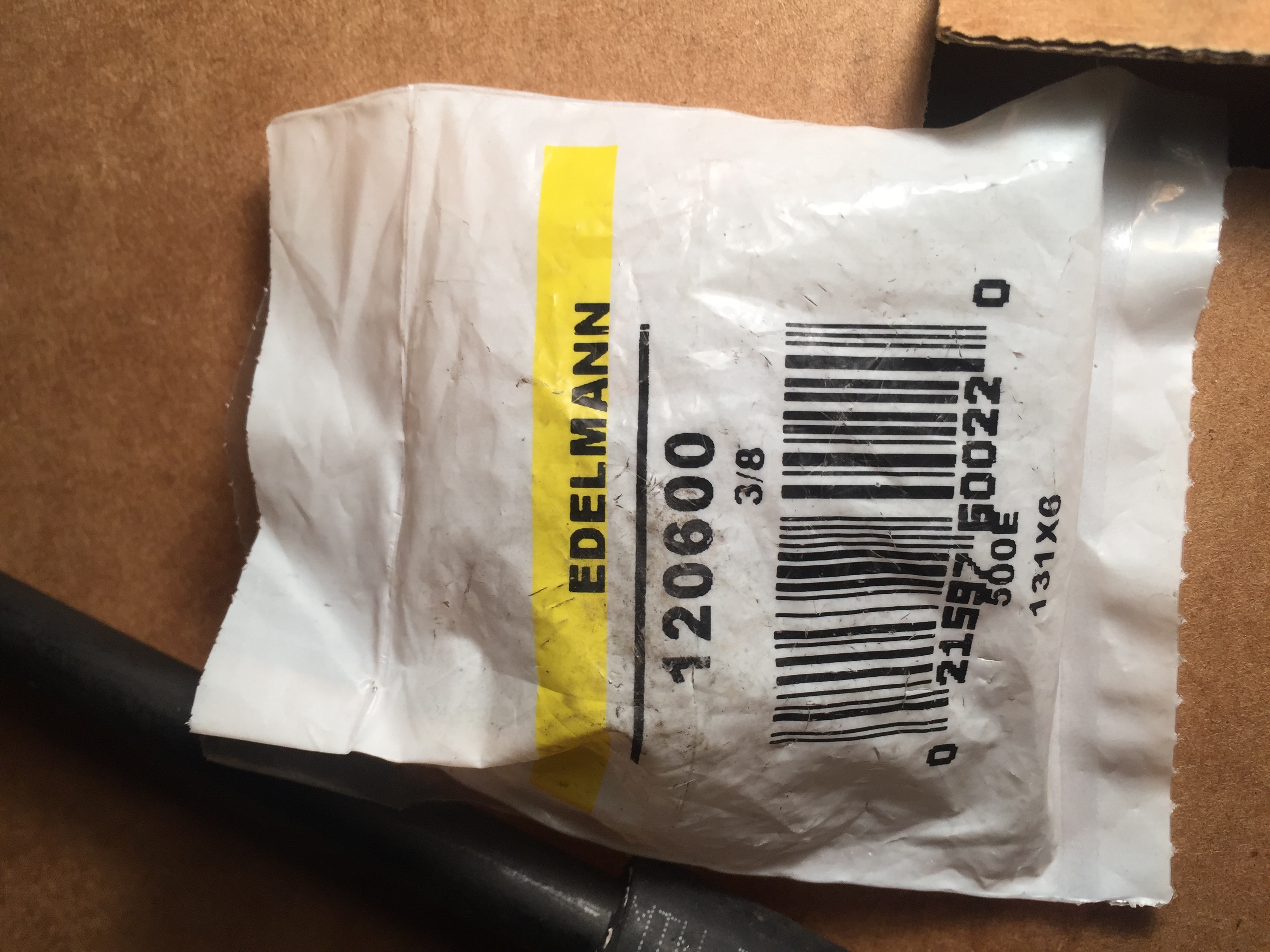

That brings me to the plugs. Correct size: 3/8" NPFT. One might thing a normal pipe plug might work. I tried 3 different ones and none worked. Finally, I learned that the OEM fitting I removed has an inverted flare end. This small piece of information makes all the difference in the world.
Bought mine at O'Reilly Auto Parts. Part #120-600.
Below you will find pics.
Old Oct 31, 2016 | 10:04 PM
  #36
RoH2's Avatar
Joined: Oct 2016
Posts: 176
From: Texas
OEM fitting and replacement plugs
Attached Thumbnails After 1 mo...the good stuff-img_0240.jpg   After 1 mo...the good stuff-img_0241.jpg   After 1 mo...the good stuff-img_0248.jpg   After 1 mo...the good stuff-img_0249.jpg

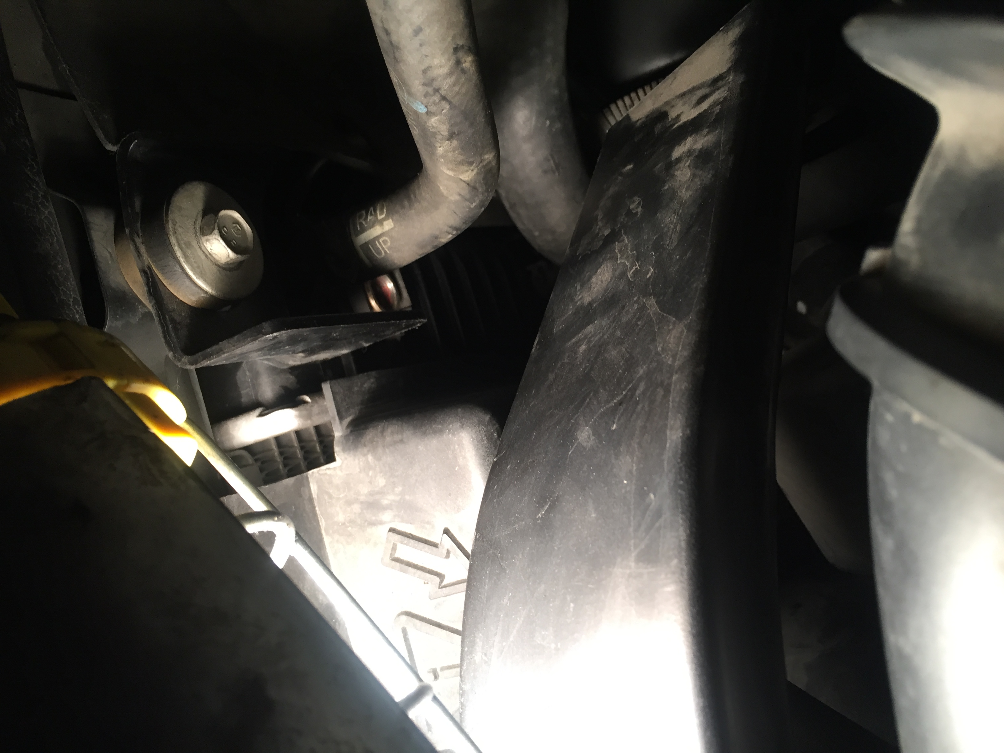

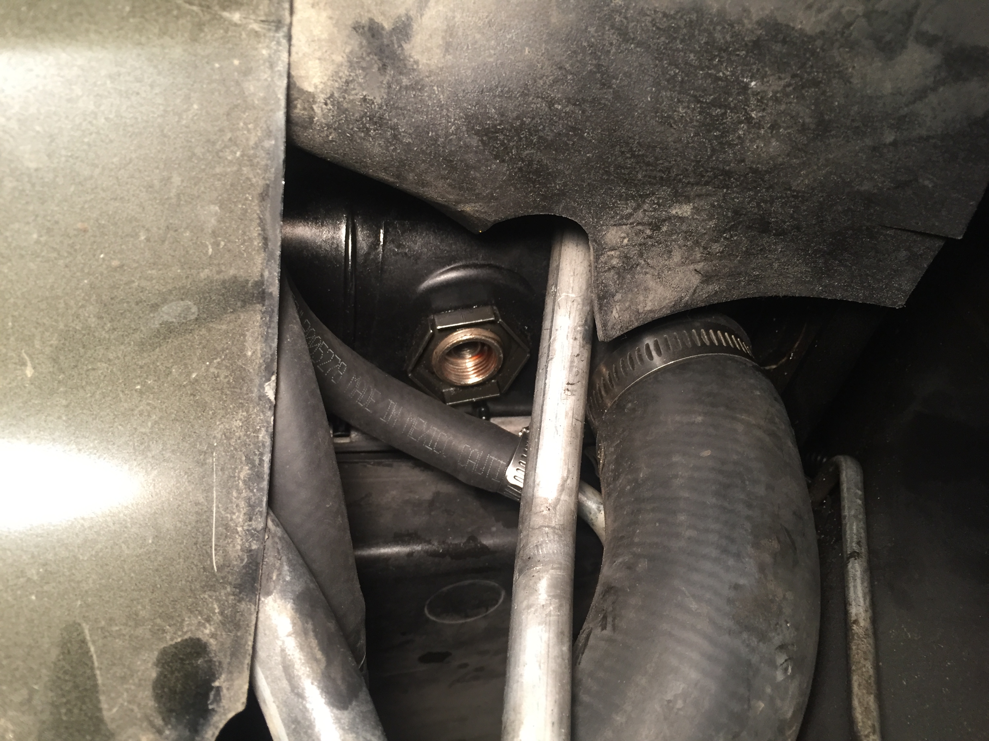

More pics
Attached Thumbnails After 1 mo...the good stuff-img_0250.jpg   After 1 mo...the good stuff-img_0251.jpg   After 1 mo...the good stuff-img_0246.jpg   After 1 mo...the good stuff-img_0247.jpg

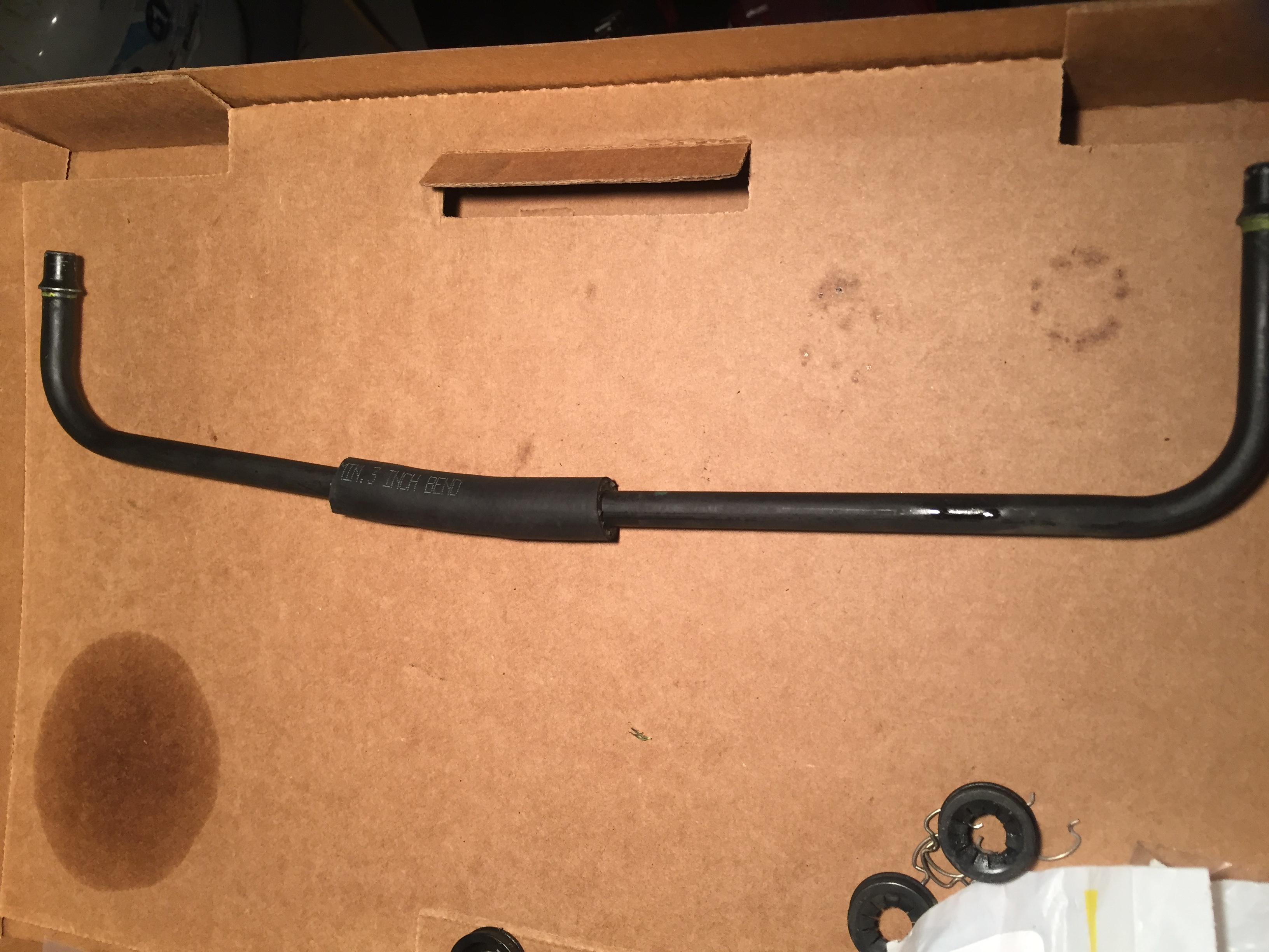

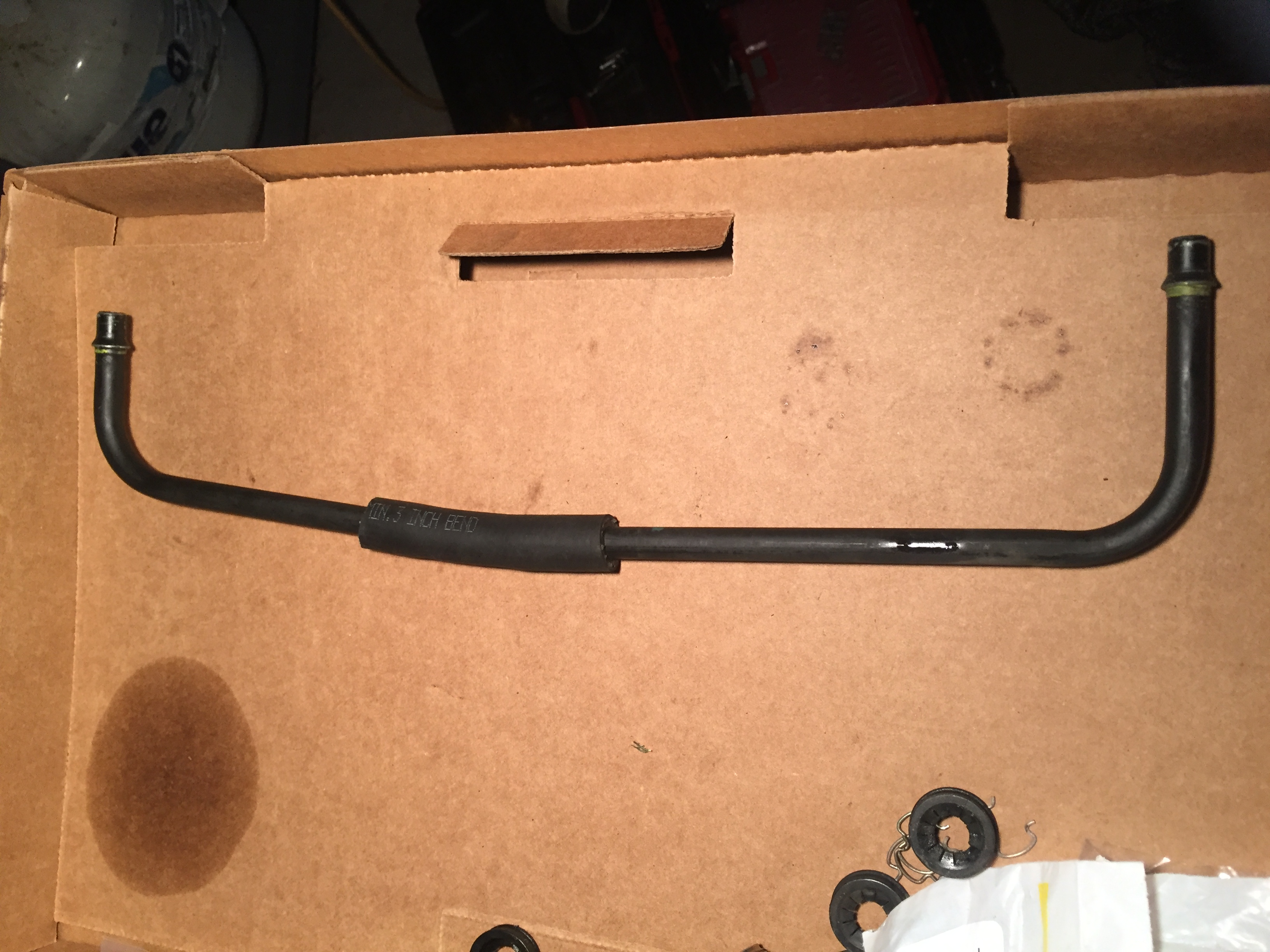

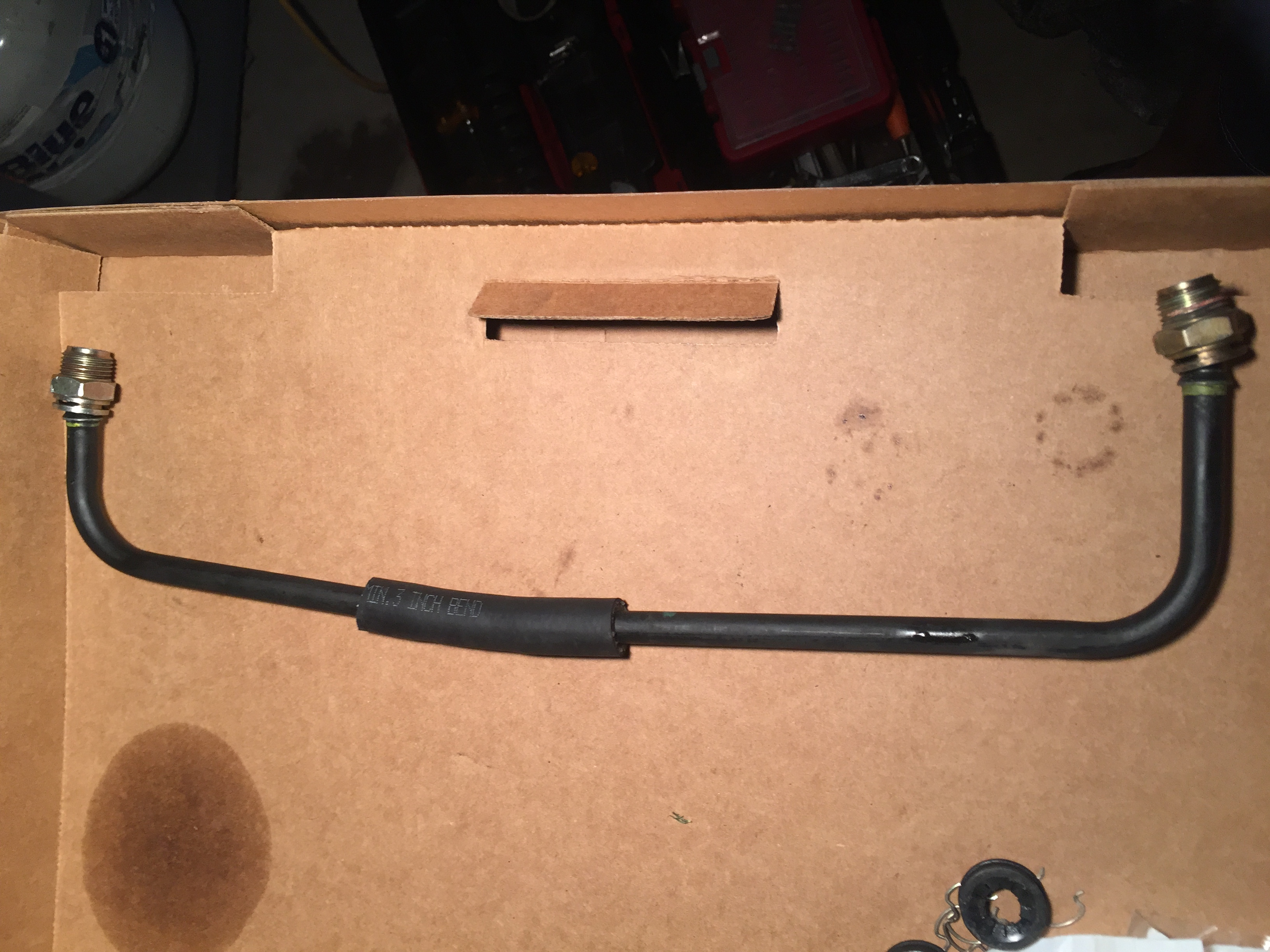

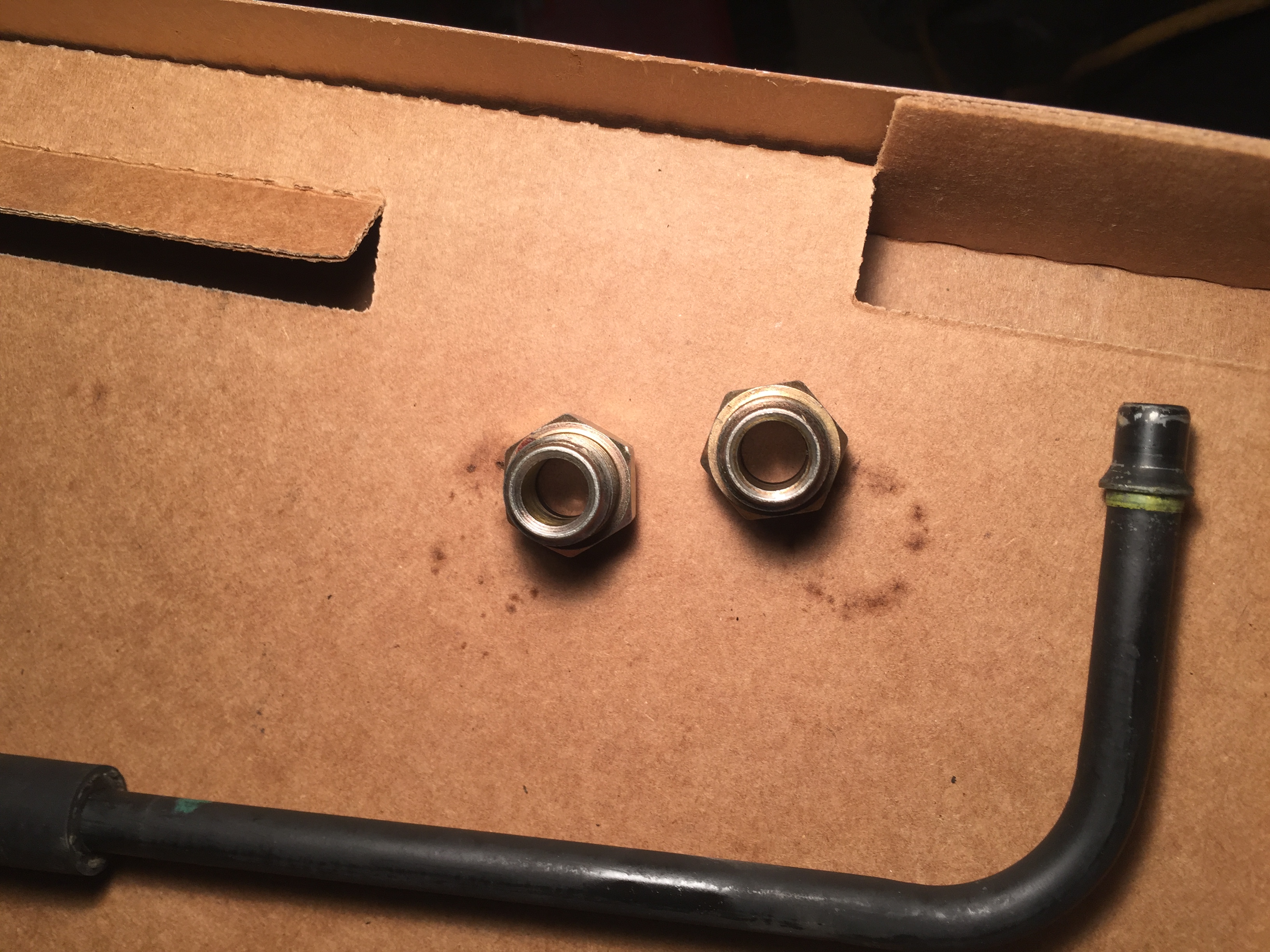

Had I struck out today, I would have used this.
Attached Thumbnails After 1 mo...the good stuff-img_0242.jpg   After 1 mo...the good stuff-img_0243.jpg   After 1 mo...the good stuff-img_0244.jpg   After 1 mo...the good stuff-img_0245.jpg
