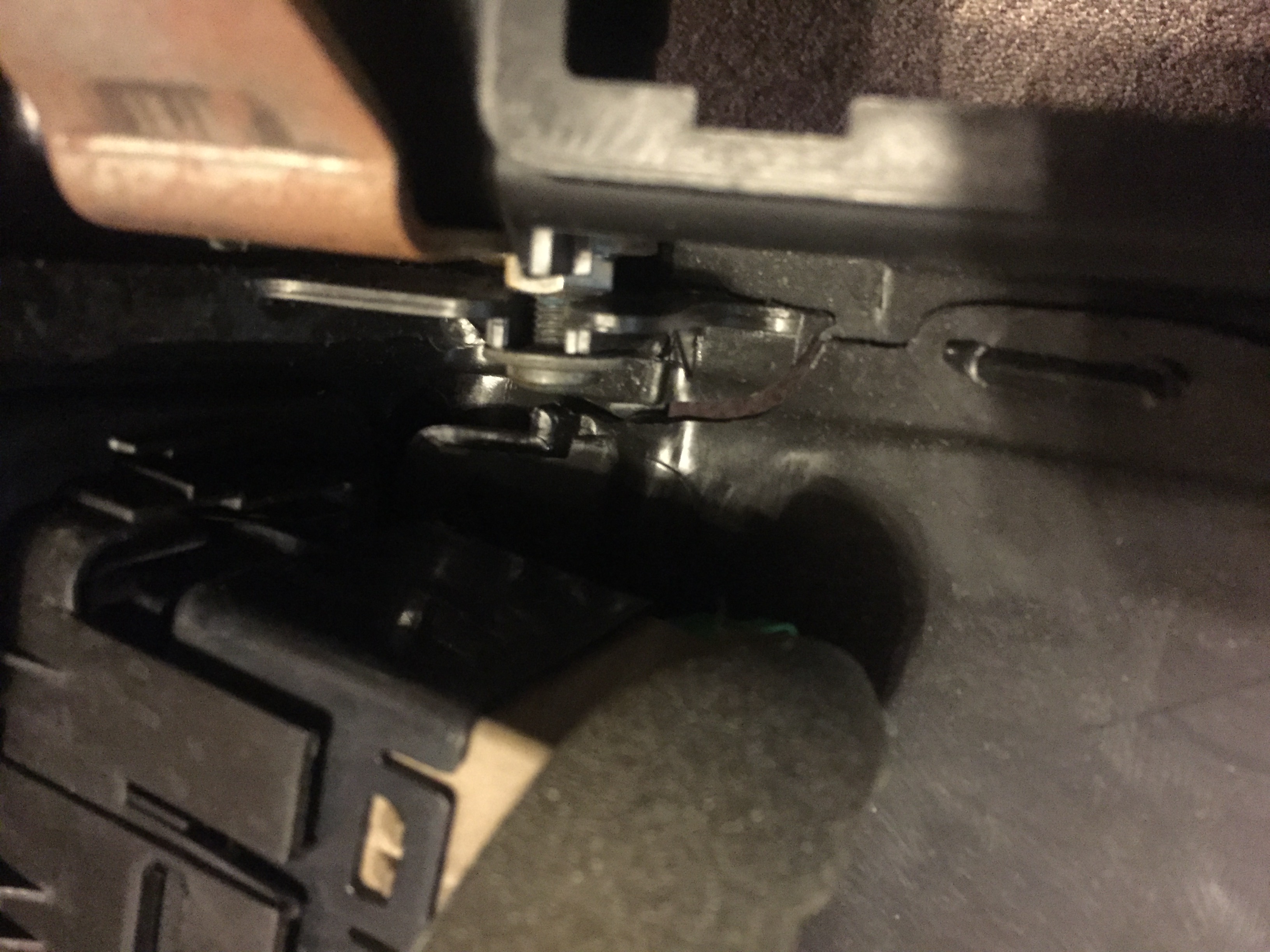

Originally Posted by RoH2
I also sprayed some WD-40 into the button shaft on the shifter handle and applied dielectric grease to the shifter shaft near the bottom where the plastic mechanism is pushed down to allow the shifter to move.
As of this morning, the movement was a bit more fluid. Truthfully, I didn't screw in all of the screws I removed in case my temporary fix doesn't really work. Time will tell, and I will update.
So, a few days ago my shifter was stuck and would not shift out of park. Since the screws were already removed, all I did was open the arm rest and pull up on the plastic insert. I stuck my hand through the opening, found the mushroom metal thing and completely pressed it in. I was able to shift out of park and on my way I went. So, this tells me my temporary fix on the internal button shaft/connector that depresses the yellow shifter shaft is actually working. However, there is something else causing me to have the stuck in park issue. I will continue to monitor and report back as this issue occurs.

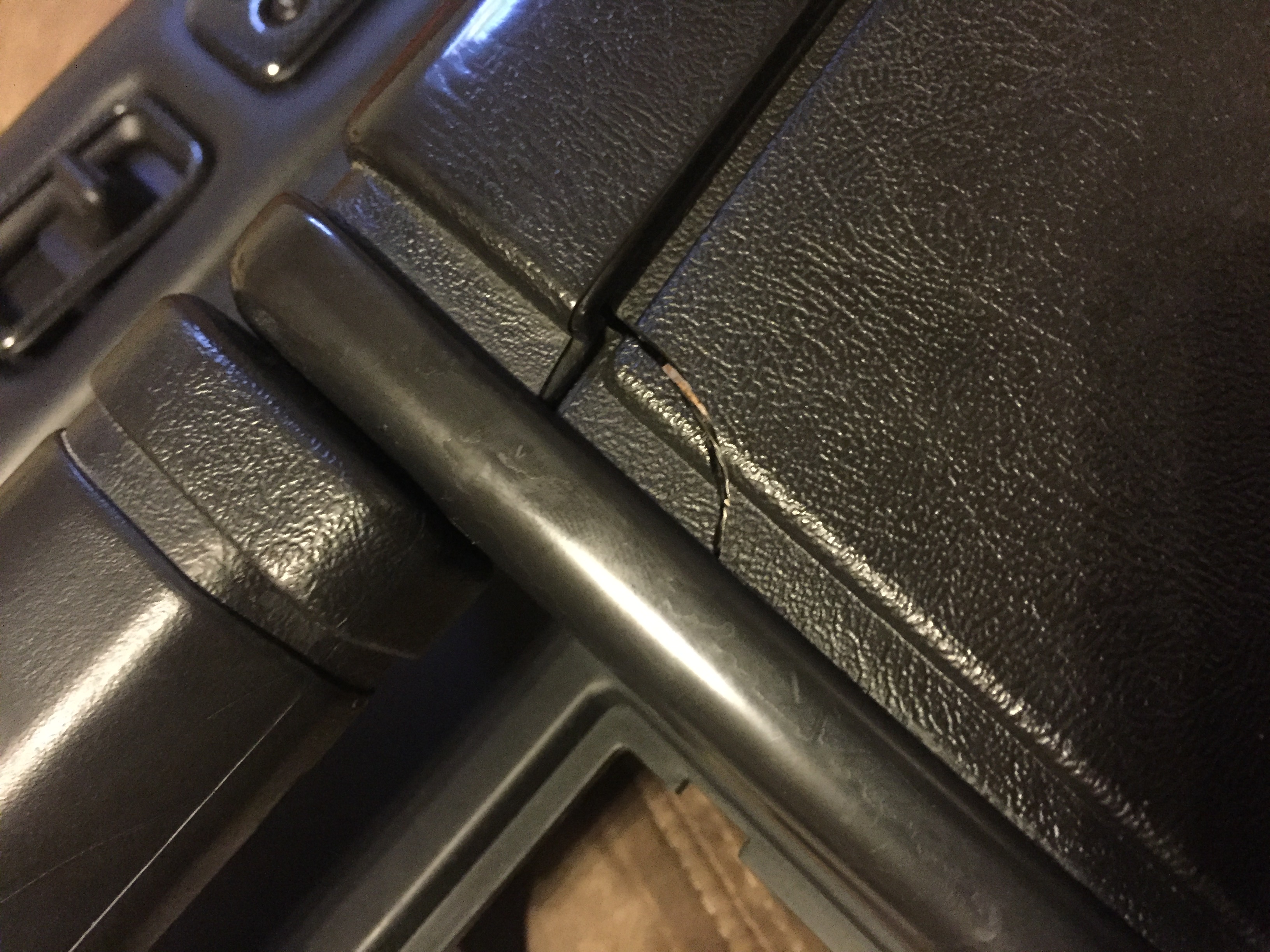

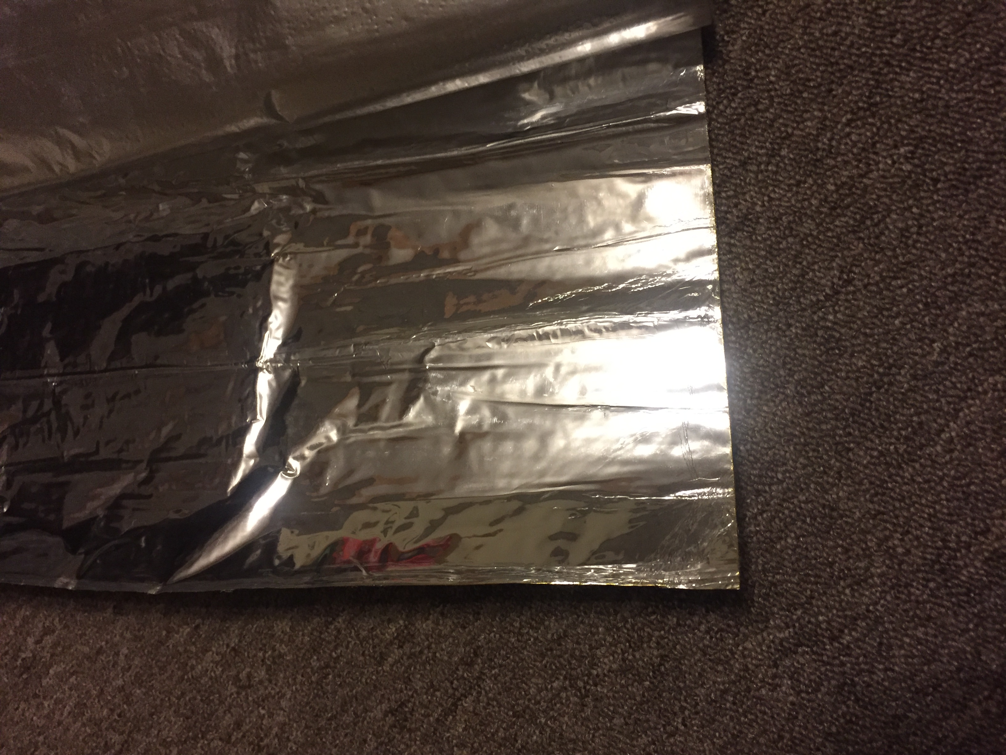

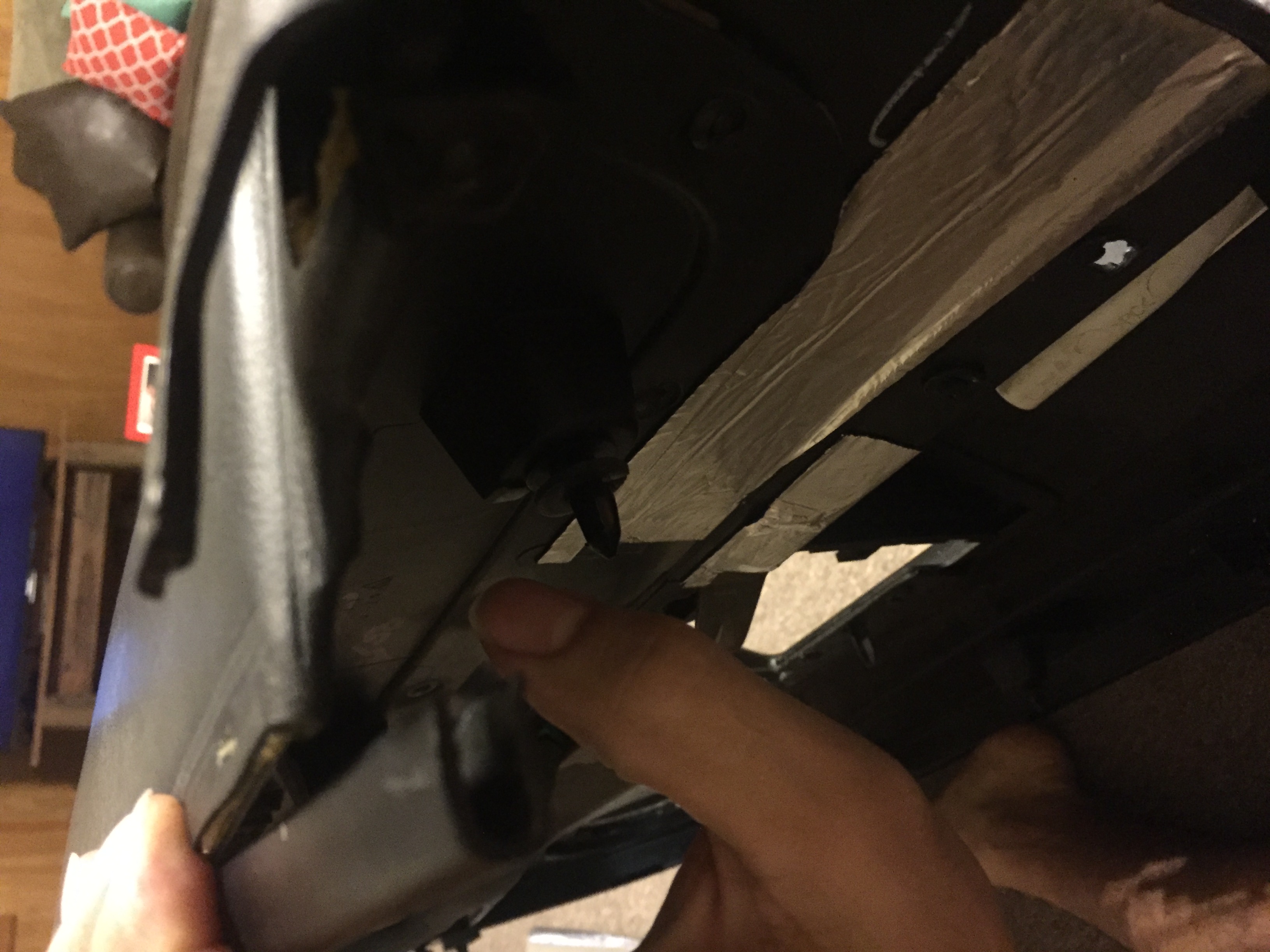

Working on driver's door panel to get rid of rattles
Attached Thumbnails After 1 mo...the good stuff-img_0254.jpg   After 1 mo...the good stuff-img_0255.jpg   After 1 mo...the good stuff-img_0256.jpg   After 1 mo...the good stuff-img_0257.jpg

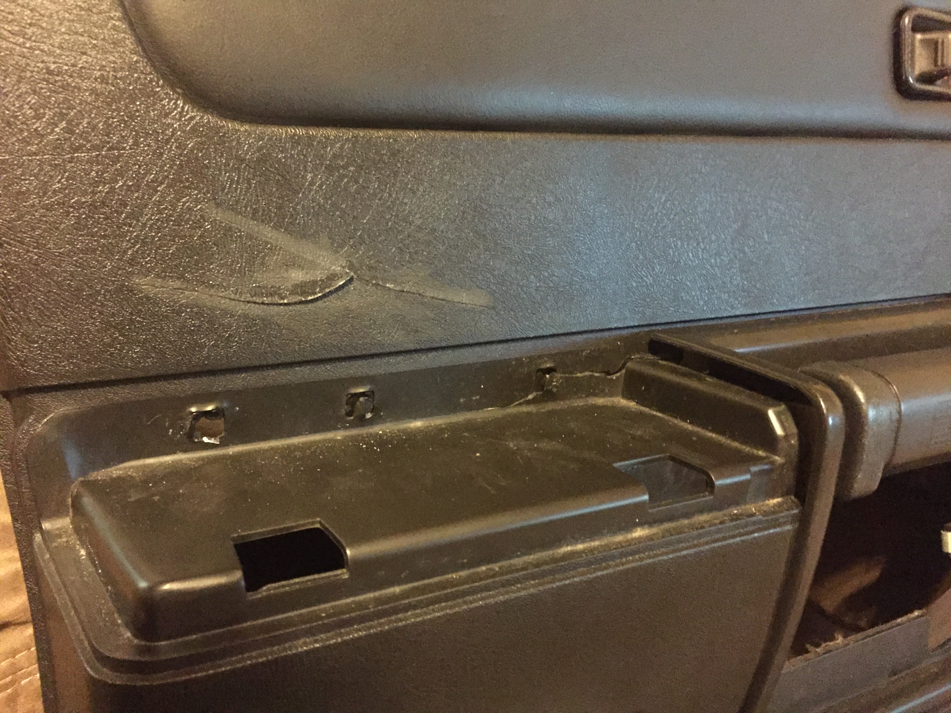

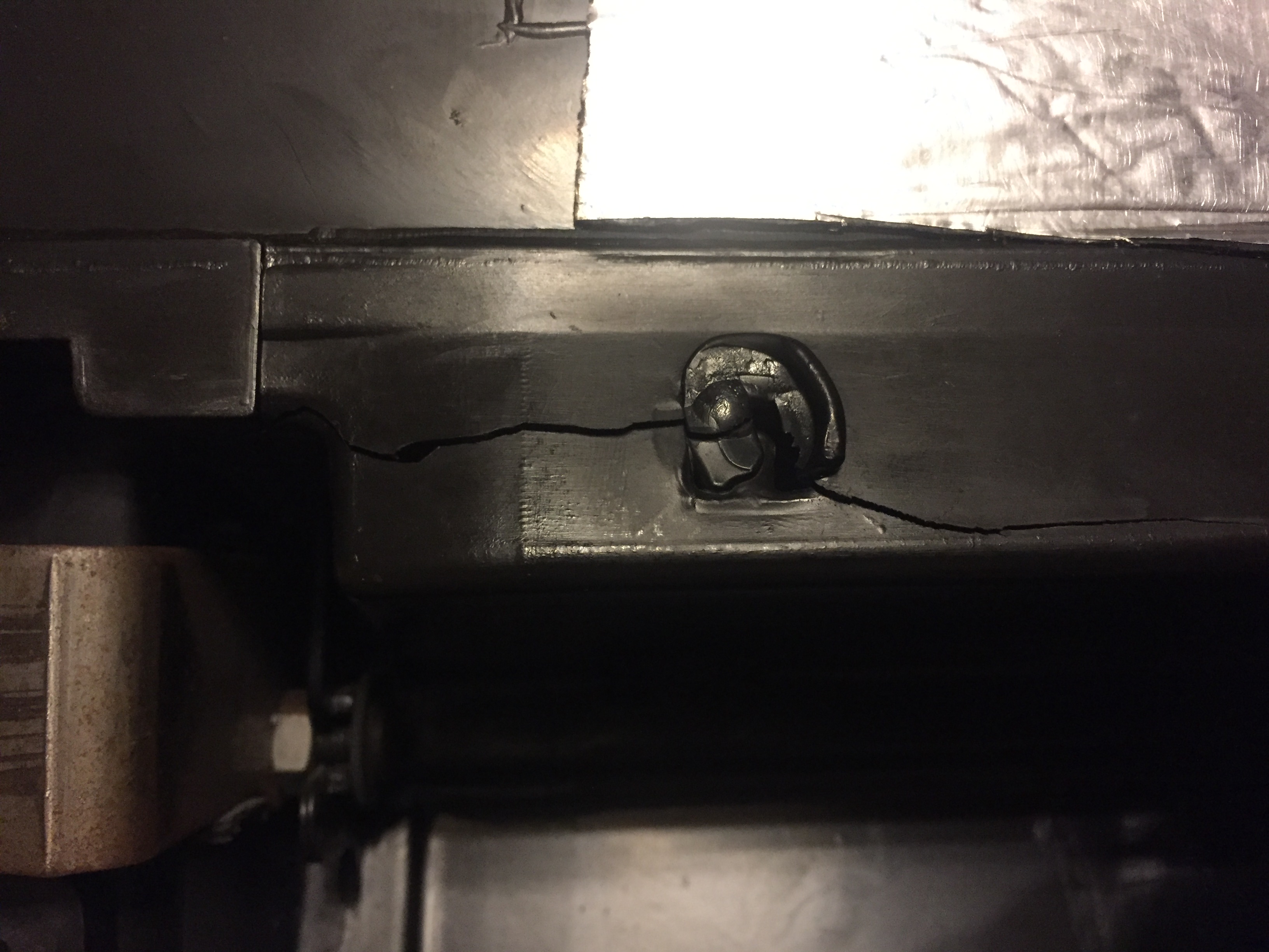

Additional pics
Attached Thumbnails After 1 mo...the good stuff-img_0258.jpg   After 1 mo...the good stuff-img_0260.jpg

Showing pics of the various cracks I found. Never would have guessed door panel was so jacked. I utilized a type of dynamat I bought off of eBay. It has a thick rubber pad with strong adhesive. Placed it on the back side of the panel near/on/around cracks. Also attached to actual door area behind panel.
Old Nov 6, 2016 | 02:49 AM
  #47
RoH2's Avatar
Joined: Oct 2016
Posts: 176
From: Texas
All of this took care of rattles. Reused 11 yr old panel tabs...panel stayed attached for 3 days then popped off.back to rattles. Ordered new panel clips off of eBay.
http://www.ebay.com/itm/361405072382...%3AMEBIDX%3AIT
Chose clips that are 1.29" in length to ensure all of the tab locations attached to door. A few of the clips no longer reached their designated locations...too short/broken. Originally bought some from AutoZone, but too short. Plan to attach sound deadening material to the other 3 doors and change out any/all tabs I find.

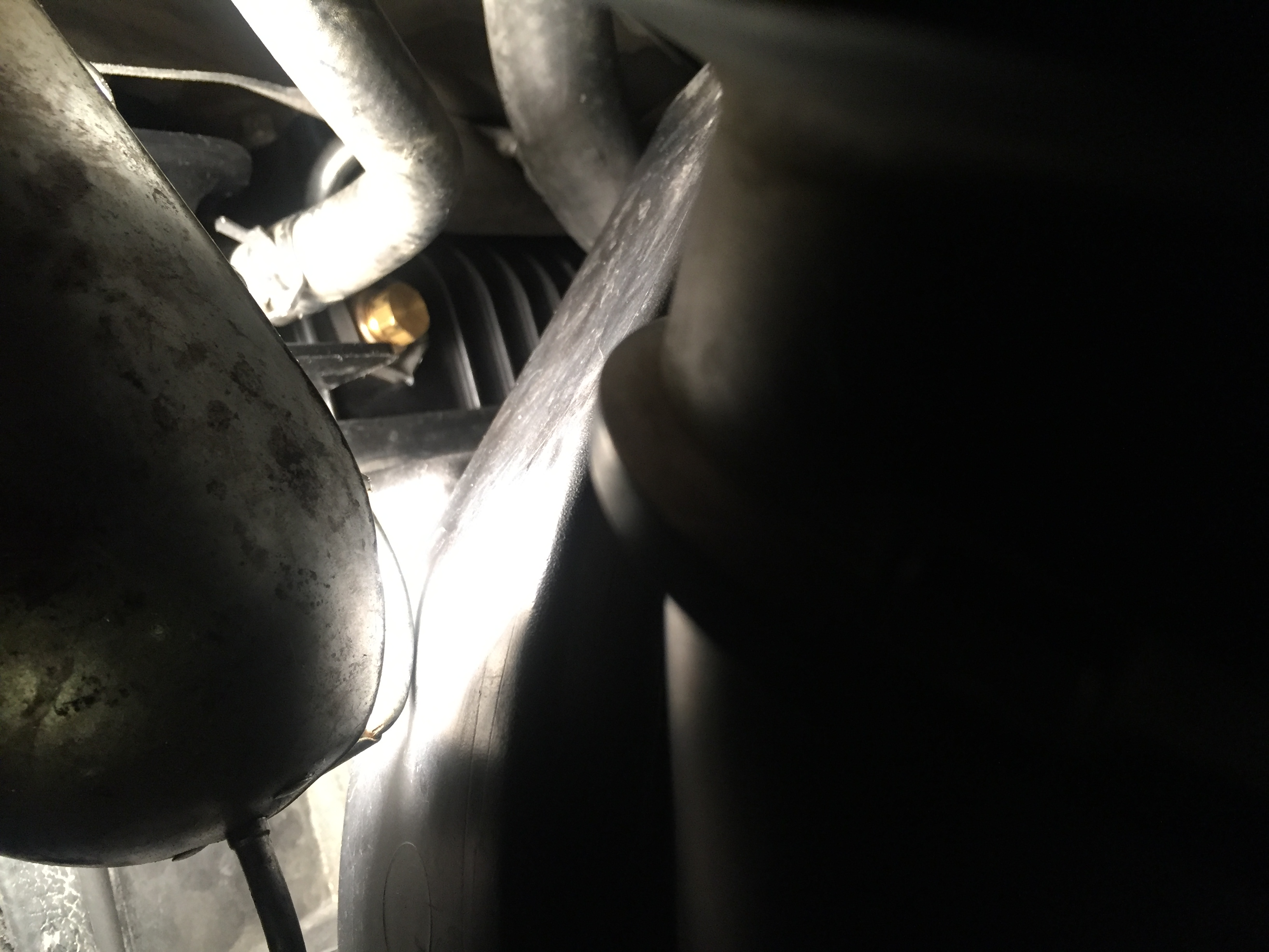

Took the H2 for an alignment on Friday.
Sway bar end links are shot. Drivers side is missing a complete bushing.
Steering stabilizer is leaking....seems to be original.
Steering gear is loose as is the lower steering shaft.
Despite these issues, they were able to align it. To my surprise, alignment was not out of spec by a large margin.
